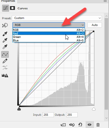

    Now you are ready to match the color using Curves:
    In the Curves settings, go the the Red Channel.
    Cilck 3 random points. For each point set the input and output values:
    • Point 1
      • Input: R1
      • Output: R4
    • Point 2
      • Input: R2
      • Output: R5
    • Point 3
      • Input: R3
      • Output: R6
    Apply the same method in Green and Blue Channel.
    After this, you should not be dragging the points around.
    If you selected your highlights, shadow and midtones carefully, you curve will not be jagged.

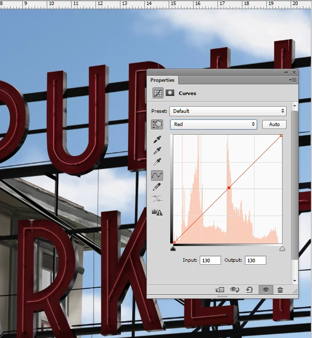

    I'm not certain that this is what you are looking for, but...
    Using the hand tool in Curves, hold shift+ctrl and click on the color you want to locate on the curve. (In the screenshot I clicked on the sky)  Each color channel will be marked (as shown in the red channel).With each channel active change the output value to the RGB value of the replacemnet color.
