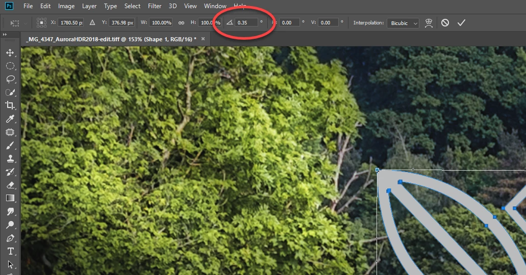

I'm a newbie to Photoshop. My mouse skills are not the best so I was trying to find out if you can use the keyboard's arrow keys to help rotate a layer?
When in menu->edit->transformation-rotate I notice the arrow keys can move up, down, left and right. Is there away increment the rotation with the arrow keys or keyboard keys?

When you are using rotate (or free transform) you can place the cursor in the tool bar, in the angle field, and type in a value. You can also use the up and down arrow to fine tune the number. Scree shot below.
Note that using the arrow keys increment/decrement the angle in hundredths of a degree! But, you can add the shift key, and the increment will be tenths of a degree.
It's probably best to type in a starting value (like 45 degrees), then use Shift-arrow to nudge the object into approximately the right rotation, then finish with the arrow alone to fine tune the last little bit.

Thank you Mike I will keep this in my notes!
