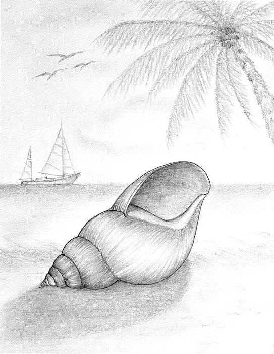

If you copy and paste this example image into Photoshop, and set your brush to Overlay, and try painting with black and white.
You'll find that you can harden up the dark lines and remove the feint lines.  It's a bit like magic, and it is a powerful, and incredibly useful trick to have in your Photoshop box of tricks.

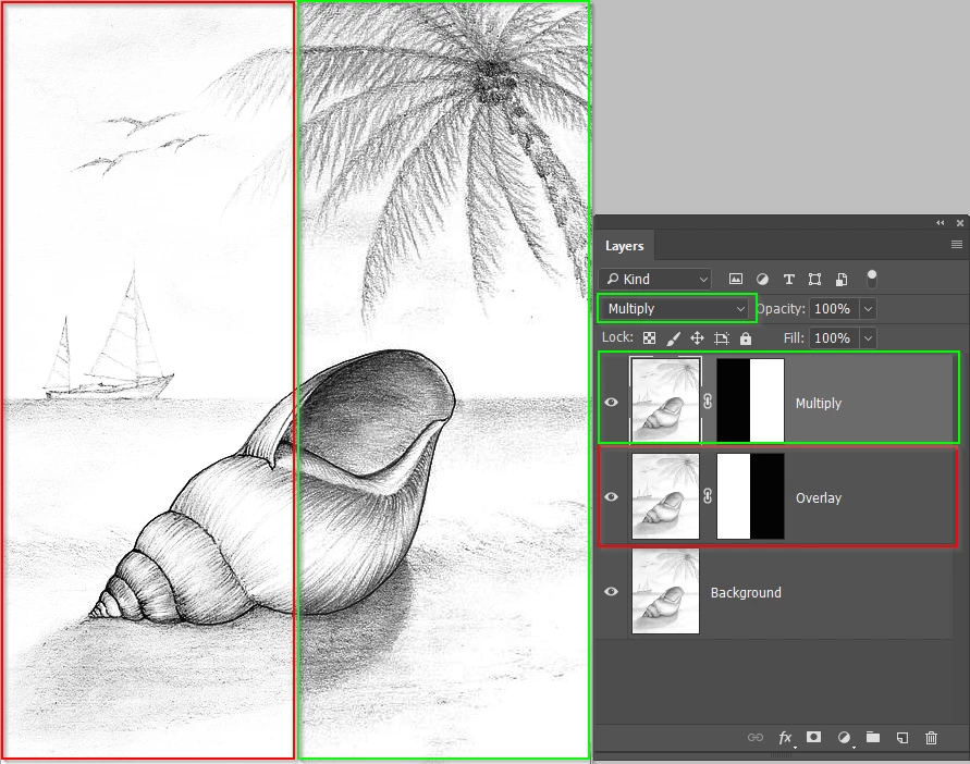

Overlay as a layer blend mode, is often used when applying texture layers.
Using the same pencil drawing and copying the layer, the Overlay blend mode (red highlight) has lightened the image by removing all those tones less than 50%, whereas the layer set to Multiply (green highlight) has reinforced the dark tones.
