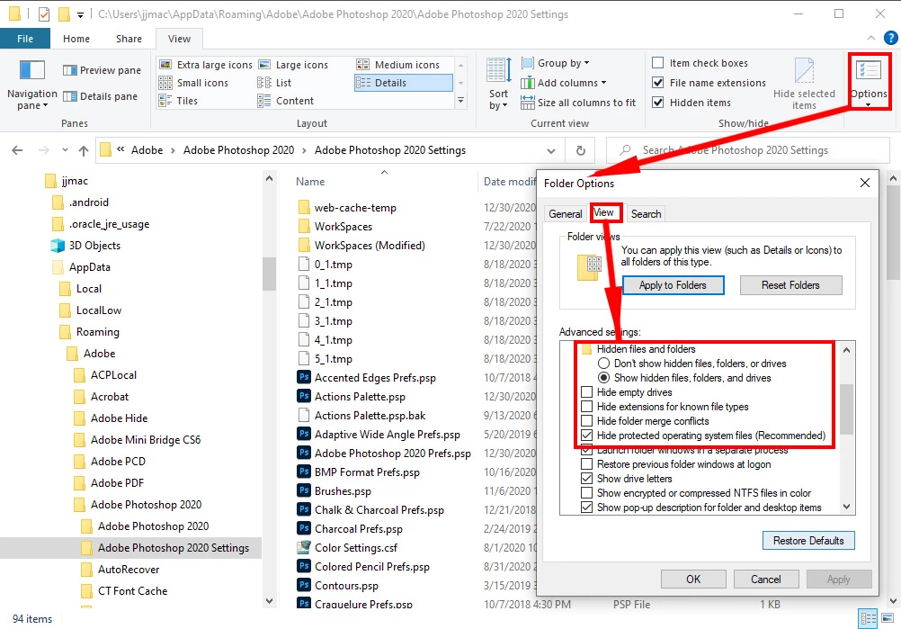

December 31, 2020
Appdata is hidden by Windows File explorer view defaults.  You need to changer your Explorer's view settings to be able to see Appdata.
JJMack
January 1, 2021
Hi, Thanks for pointing out. I forgot this in the 'panic'. However, I find there are NO files in the folders of Appdata.. \presets, either on laptop or desktop, so PS is holding them somewhere else.
