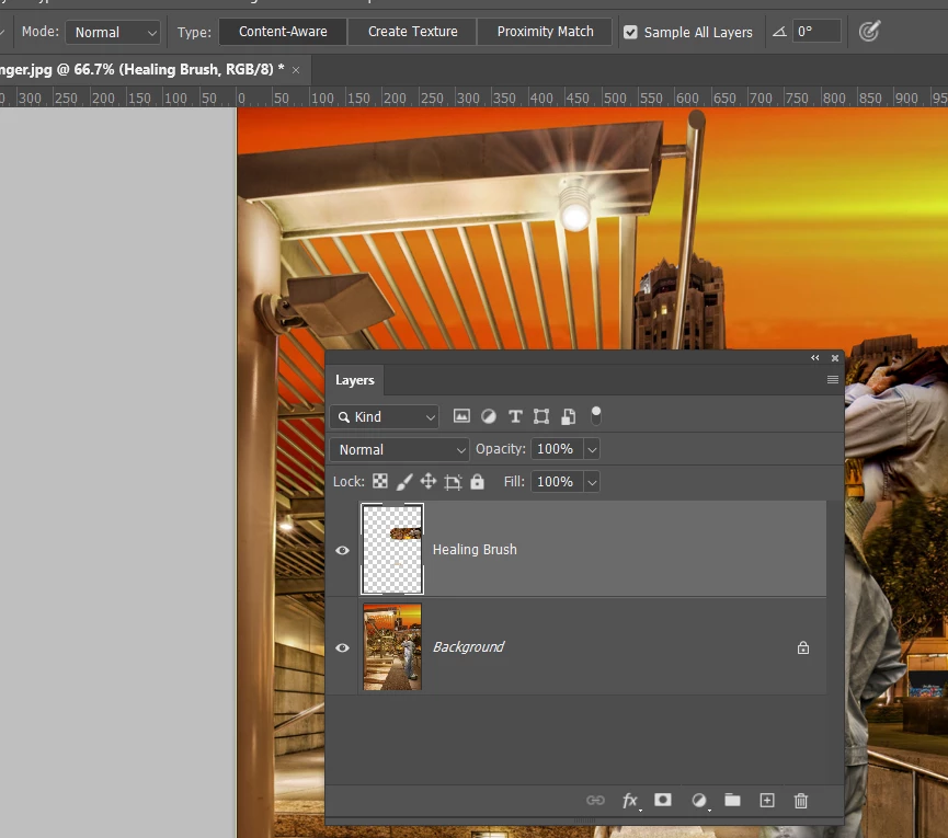

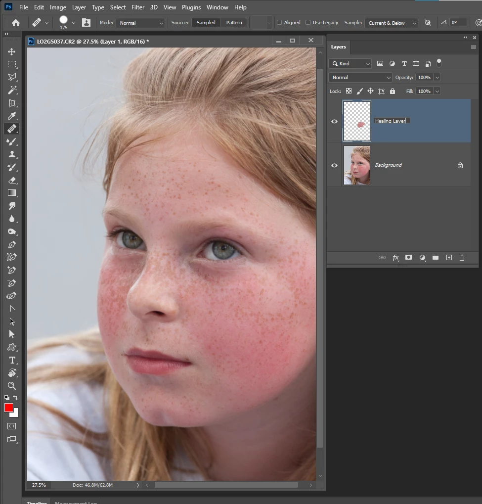

Create a new layer, and turn on Samplee All layers.  Use the Healing Brush in the new layer and the original layer is unaffected.  I expect this is what JJ was suggesting.
