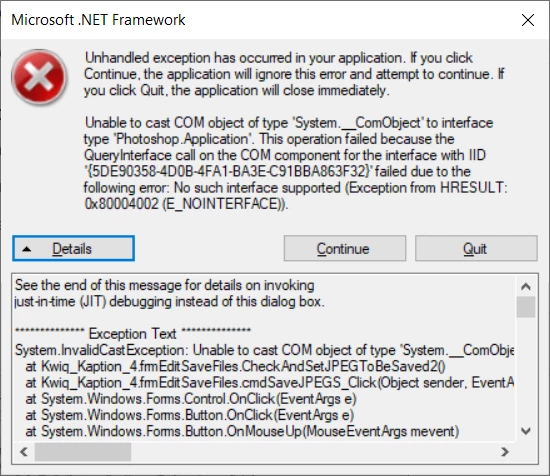

I have been using VB scripting for many years with Photoshop without any issues.
I have just updated to PS V23.0 and have now got the following problem, it has basically crashed.
I have rolled back to V22.5.2 where it was working properly, now it doesn't?
I am using Win 10 Pro v 10.0.19042 build 19042.
The script is to caption and save an image to a specific folder. I need this for my business and I am stuck without it. As mentioned above it has worked fine for years!
Note that I have not carried out any other updates to other software prior to this issue.
Can anyone help please?
Thanks
Correct answer QPR John
Lumigraphics - yes I did write the script.
I manged to fix this problem, for those that use Visual Studio 2019 the references were set at 'Adobe Photoshop 2021 Object Library' the latest version is 2022. I simply made reference to the later version and it works fine again - happy days.
Also - not sure if this helps anyone but I had a similar problem a while ago where my app kept crashing and the problem was that I kept the older versions of PS on my PC, and when my code was trying to access it would hang for a while and then report an error. I removed the older version of PS and all was good.

Older topic but I wanted to reply with the solution to this, as it had me banging my head against the wall for almost an hour this morning. I believe the issue has to do with having more than one version of photoshop installed at the same time. If you do, you can specify which version of photoshop you want to use. So, if you'd like to use Photoshop CC 2021, use:
Set photoshop = CreateObject( "Photoshop.Application.150" )
 I assume CC 2022 would be "160". I found this info on the forum, here. It says for version 15 use "Photoshop.Application.80" so I just counted up. Note that CC 21 is version 22 (thanks, Adobe).

Did you write the script?
QPR JohnAuthorCorrect answer
November 2, 2021
