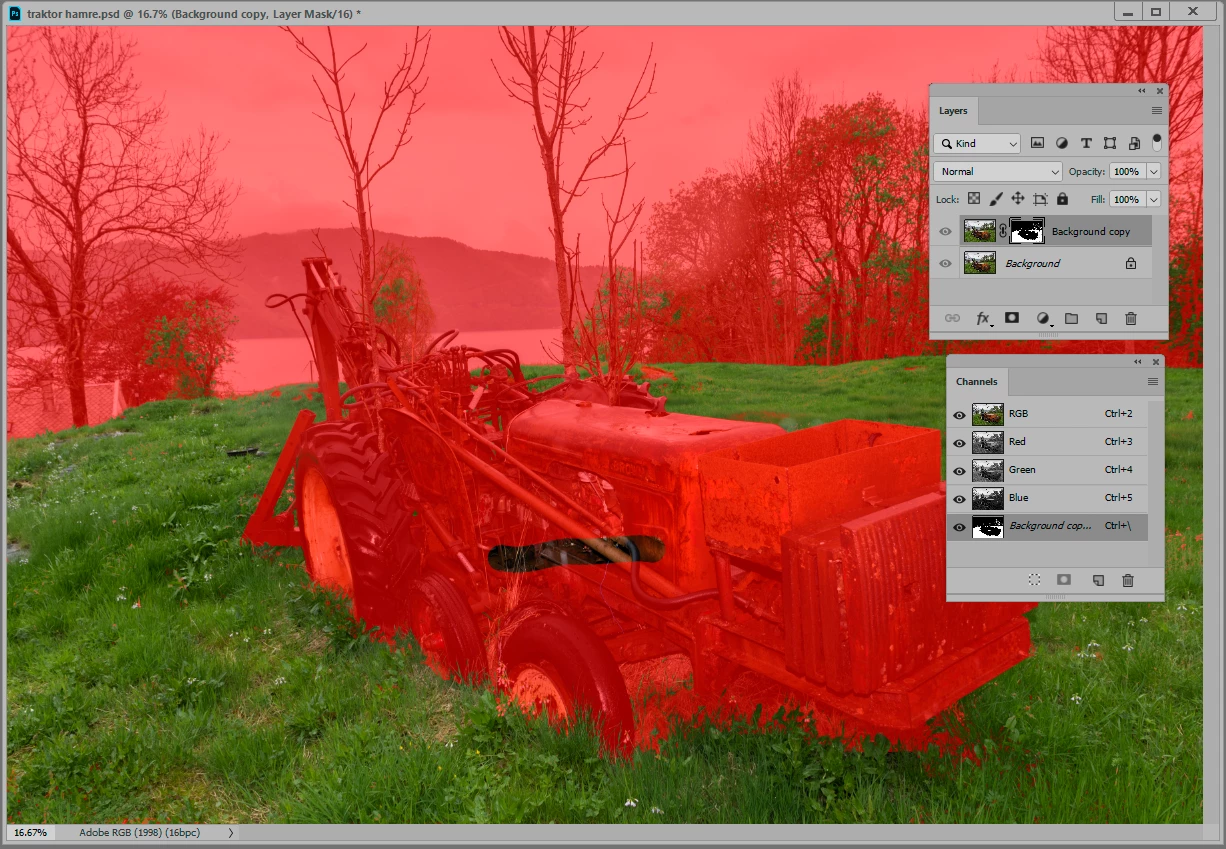

    What I don't understand is why you don't use a mask instead of a selection copied to a new layer?
    With the selection method, as you describe it, you're burning all the bridges behind you. It has to be perfect the first time because you can't go back.
    Using a mask instead, you can refine it to your heart's content as you go along. If you discover it's not perfect, you just paint in the mask until it is. That's your live preview.
    You can also turn on the mask rubylith overlay as you work:

    What's a "selection layer"? Selections are global. Are you talking about masks? In that case you already have a live preview - or you can turn on the mask overlay.
    I understand what you're asking (I think), but there are already ways to do that...?
