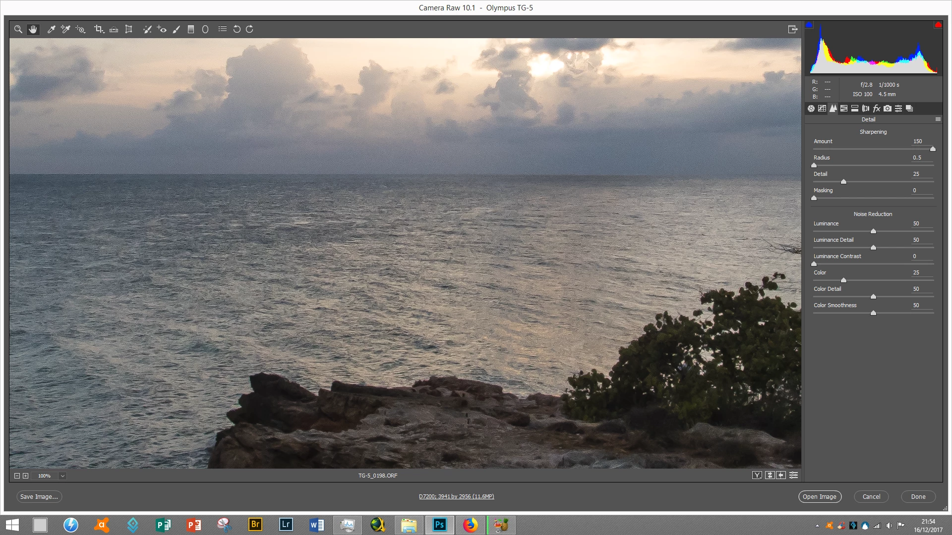

After doing a very small rotation to get the horizon level. Doing so shows a "grid" of sharper and blurred boxes. It is repeatable in different images and seems to matter how much of a degree the image is rotated. I'm not sure if this is just an unfortunate side effect or an actual issue.

    Ah - that explains that - and yes I can see it.
    Can you try something? Go to Preferences - Camera Raw and turn off Use Graphics Processor. Then open your image and repeat the rotation above.

    Are you referring to the horizon on the left of the image?  If not, can you tells specifically where you are seeing the problem?

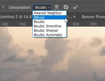

    I don't actually know what interpolation ACR uses when resampling RAW files, but you could try leaving the horizon skewed untill you open the image inside Photoshop, and using Free Transform to straighten it.  That way you can control what Interpolation is uded from the Options bar.

    Sharpening at 150 !!!!!   No wonder you can see artifacts. .
    Seriously - if an image needs that much sharpening, try less sharpen and increase local contrast (clarity slider) and see if that works better with less visual artifacts.

    Its at 150 to show the problem more. I'd never have it that high ever! You need to zoom in at 100% to clearly see it.
