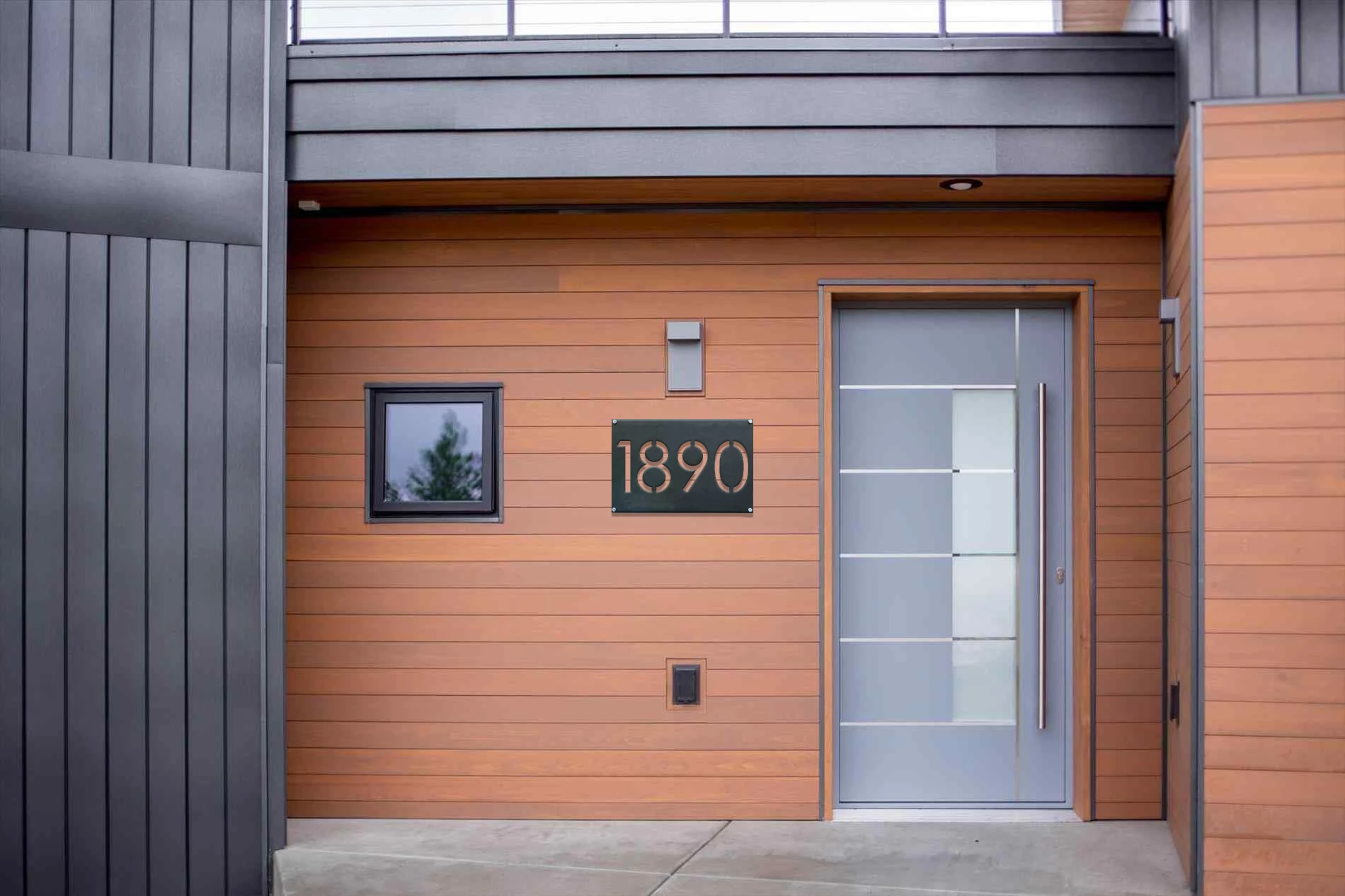

I am looking to take a design I make in illustrator and place it in a real life image...like on the side of a house for my address signs or on a shelf or above a fireplace for my interior artwork.  I know it is pretty easy to simply overlay a graphic over a picture but I am looking for a more quality result.  Because my work is all made of metal it has some depth to it so simply placing the graphic on an image looks pretty fake.

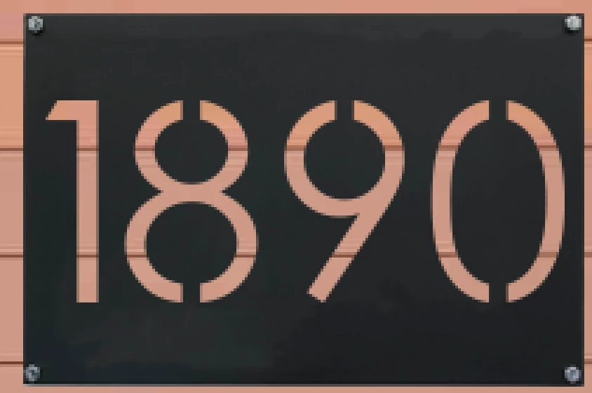

One idea I had that worked decently was to cut out a blank sign, paint it, and take real photos as I usually do.  Then crop the photo to be only the blank sign and nothing else.  I then placed the cropped sign image over the scene (aka front door of house).  I then used a clipping mask and applied the design from illustrator over the image of the sign which then basically made the "cuts" that an actual sign would have and revealed the background scene behind it (see attached image).
The problem with that is it doesn't have any depth so it still looks pretty fake.  Any suggestions or help on what process I should study up on would be greatly appreciated!  Once I figure out what works I need to reproduce it many times with different items so I need to find a good workflow...

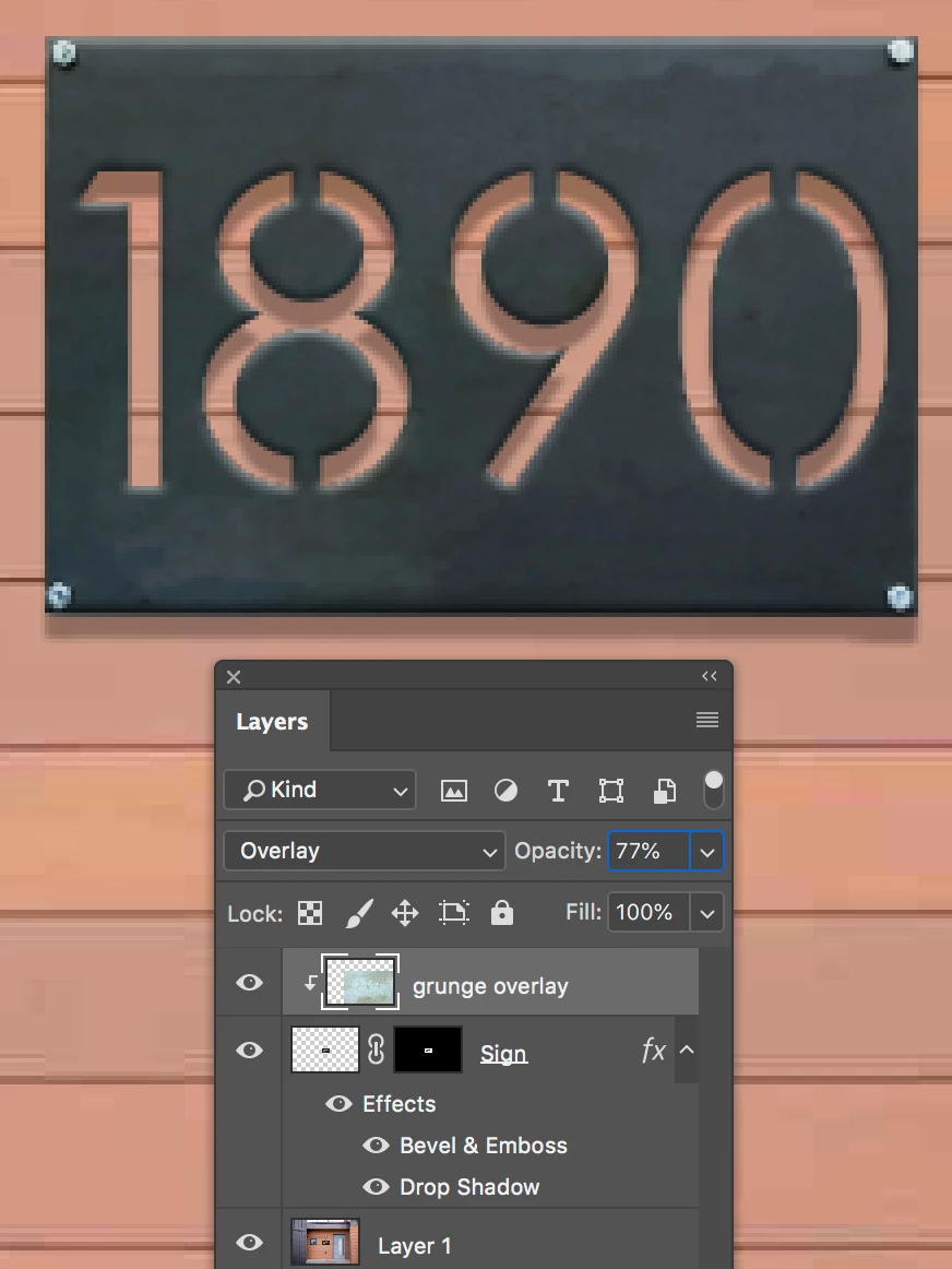

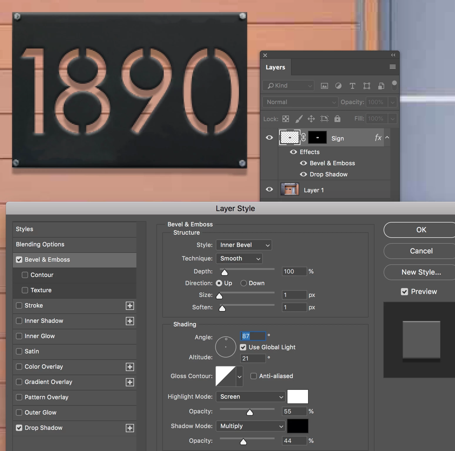

I would recommend using Photoshop to adjust beveling, texture and lighting as needed to your illustrator art pasted into Photoshop.

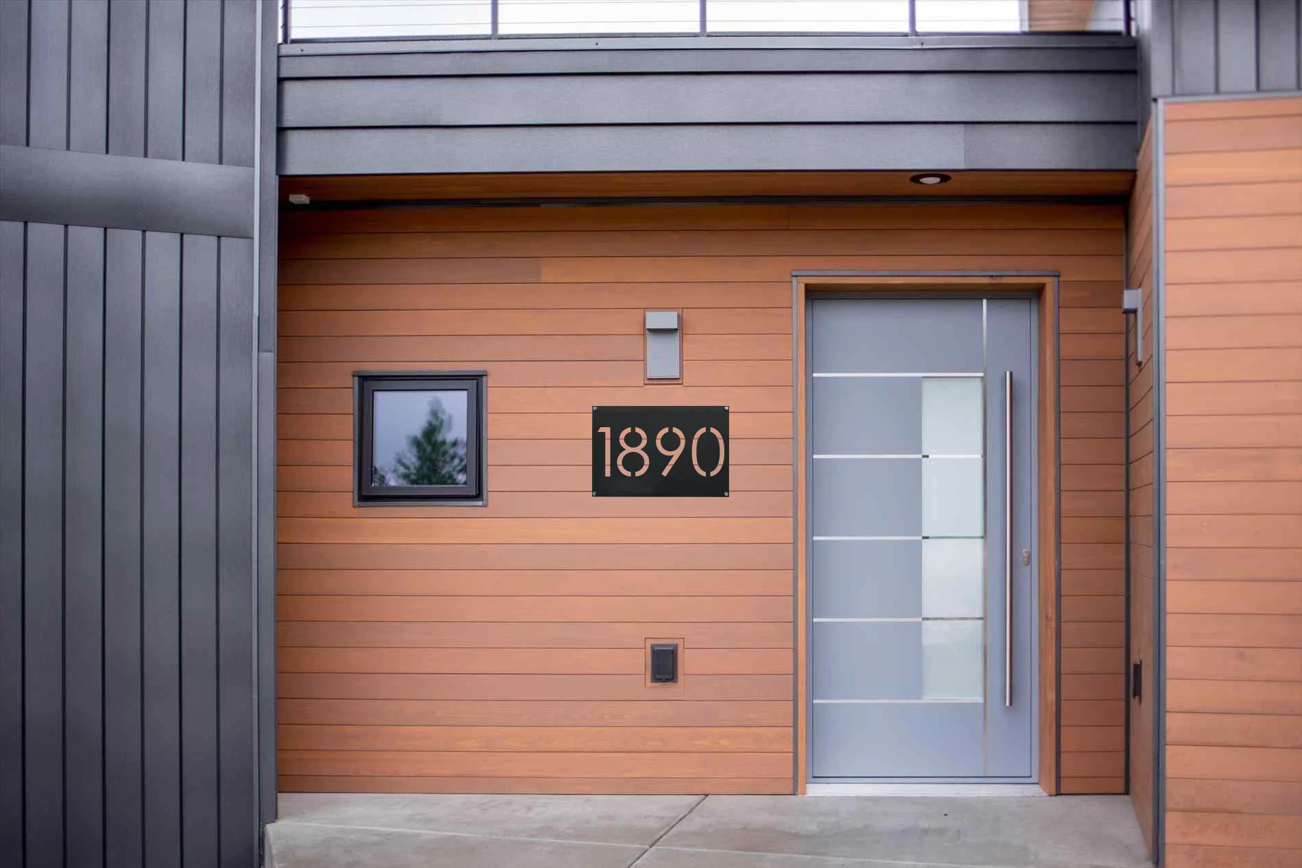

Below is your original
add some bevel and drop shadow effects
You can also clip a texture to you sign shape and use blend mode, in this case I use an image (you could shoot with a digital an uncut sheet of metal).

October 11, 2018
You can try to see if Adobe Stock has some assets that you can you use Stock photos, royalty-free images, graphics, vectors & videos | Adobe Stock . One big pro of using Adobe Dimension is that it automatically correct the perspective, light and reflection of the project, so you can achieve pretty realistic renders.
