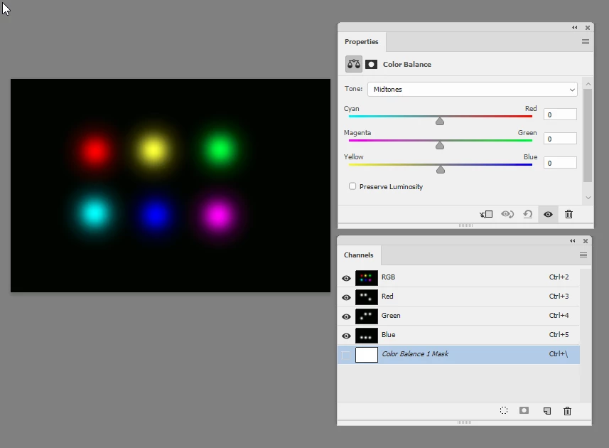

Hi
It depends on whether Preserve Luminosity is checked.

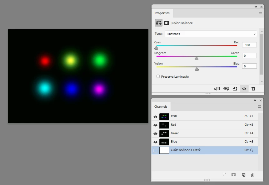

For example, without Preserve Luminosity checked reducing red by moving the slider to the left,  just reduces the levels of the red channel in a similar way to moving the gamma slider in a levels adjustment but with less range in the adjustment.
Start :
Reduce red

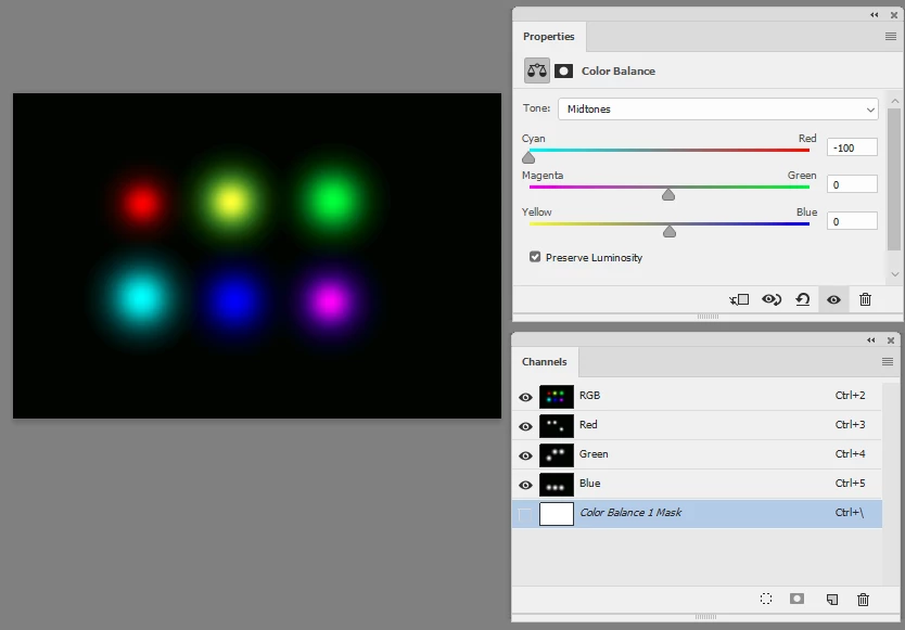

With Preserve Luminosity checked, reducing red reduces the levels (actually the gamma) in the red channel but also increases the levels (again in reality the gamma) in the blue and green channels
Edited to add the correct third screenshot
