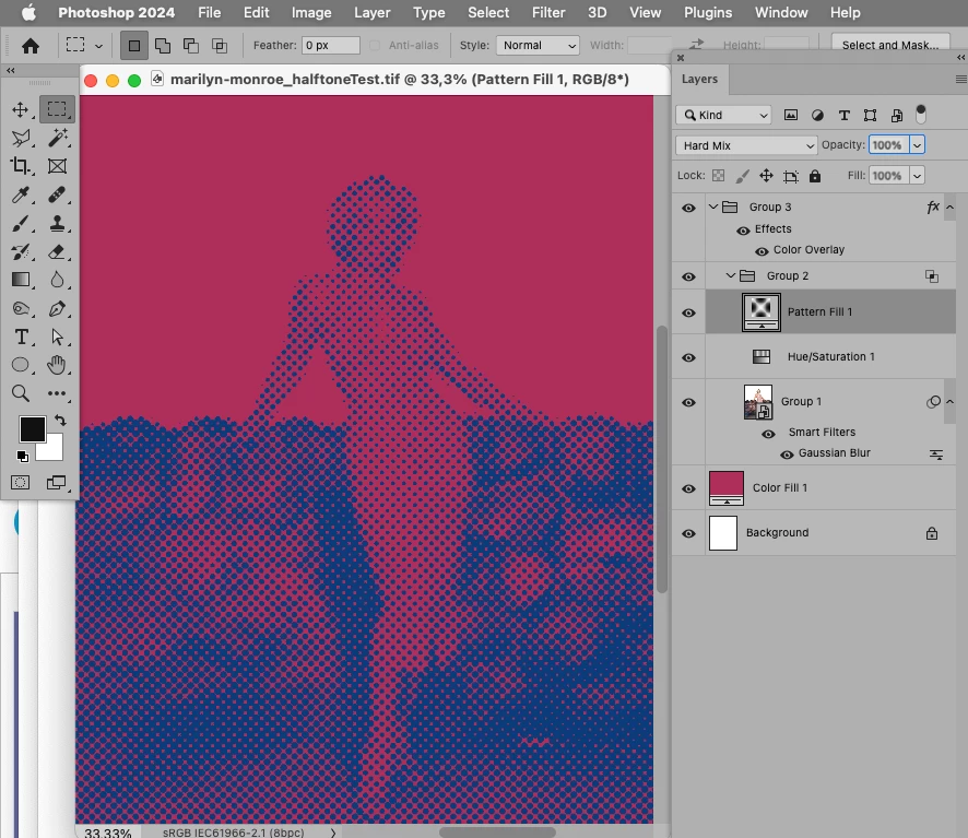

And just to add to the options one more: Hard-Mix-Pattern Layers.
