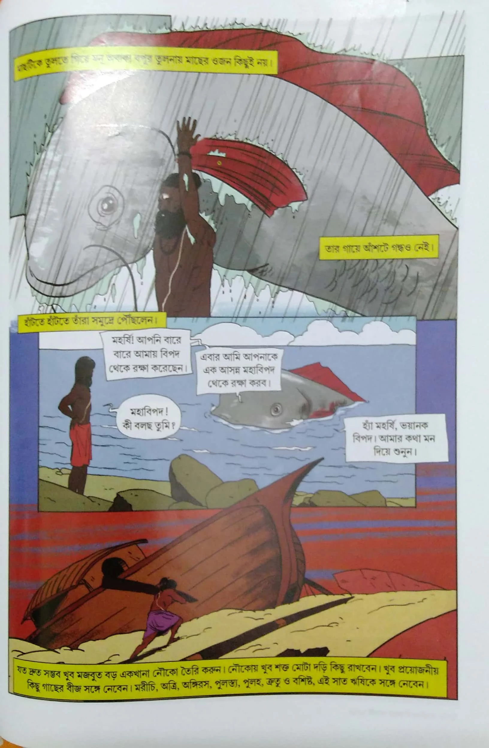

You can see for yourself on screen. Just proof to the CMYK profile you'll be using, and you can see any desaturation directly. There's nothing to "do" with it assuming it's the right profile. It's just the limitations of this ink on that paper on that particular press.
Off the top of my head this looks pretty normal to me, considering that this is a photographed page that is obviously not directly comparable.

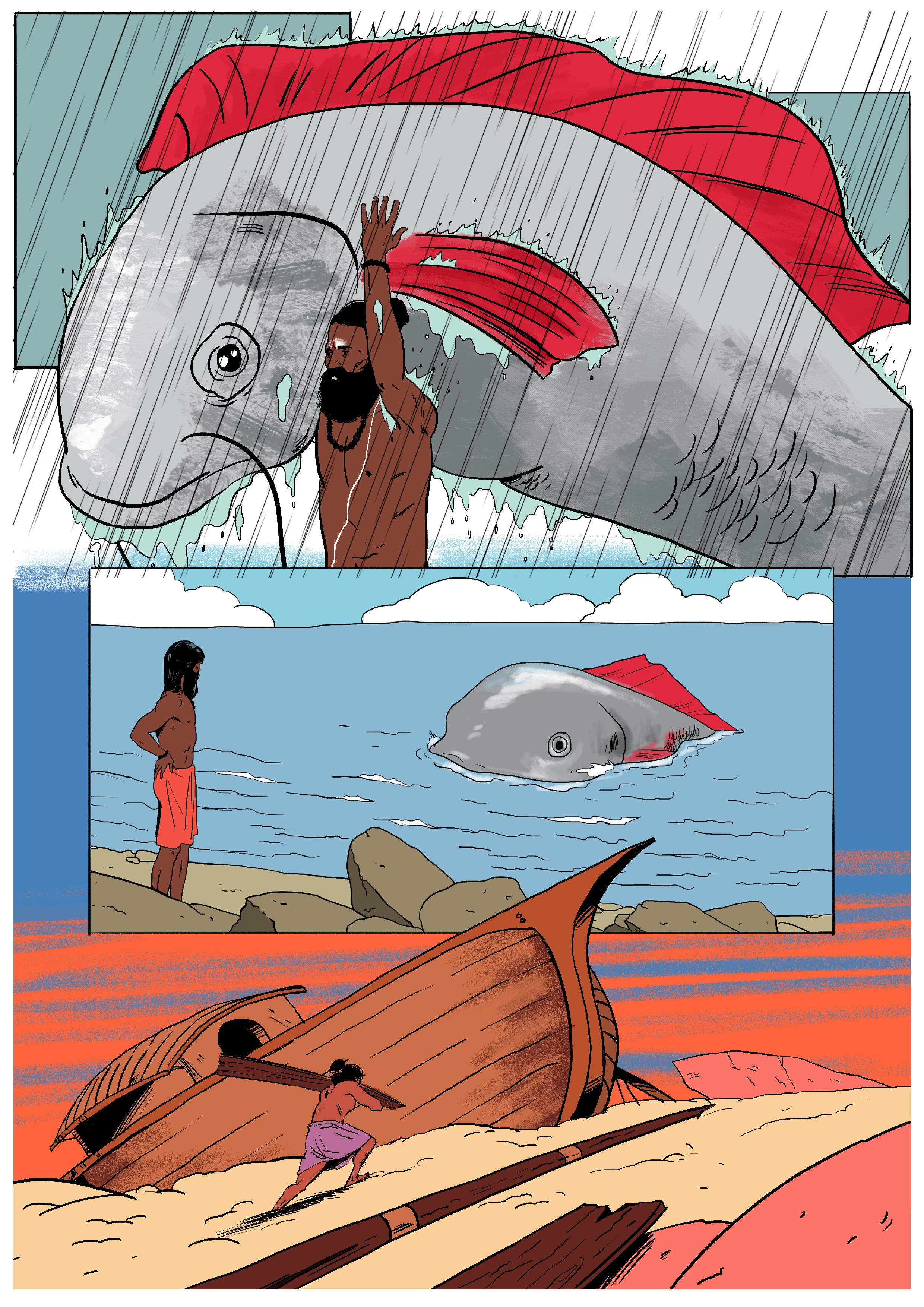

Yes, here is an example -
Here is my RGB illustration which is bright.
And here is the printed version which is darker. I clicked the photo below on my phone, so it isn't perfect, but the darker shades are visible on the character's skin, the rocks and the wooden elements in the last panel.
Is this normal? If so then how can I solve this issue? Because this is an issue for me if the colors I am working on get changed in the final print!
