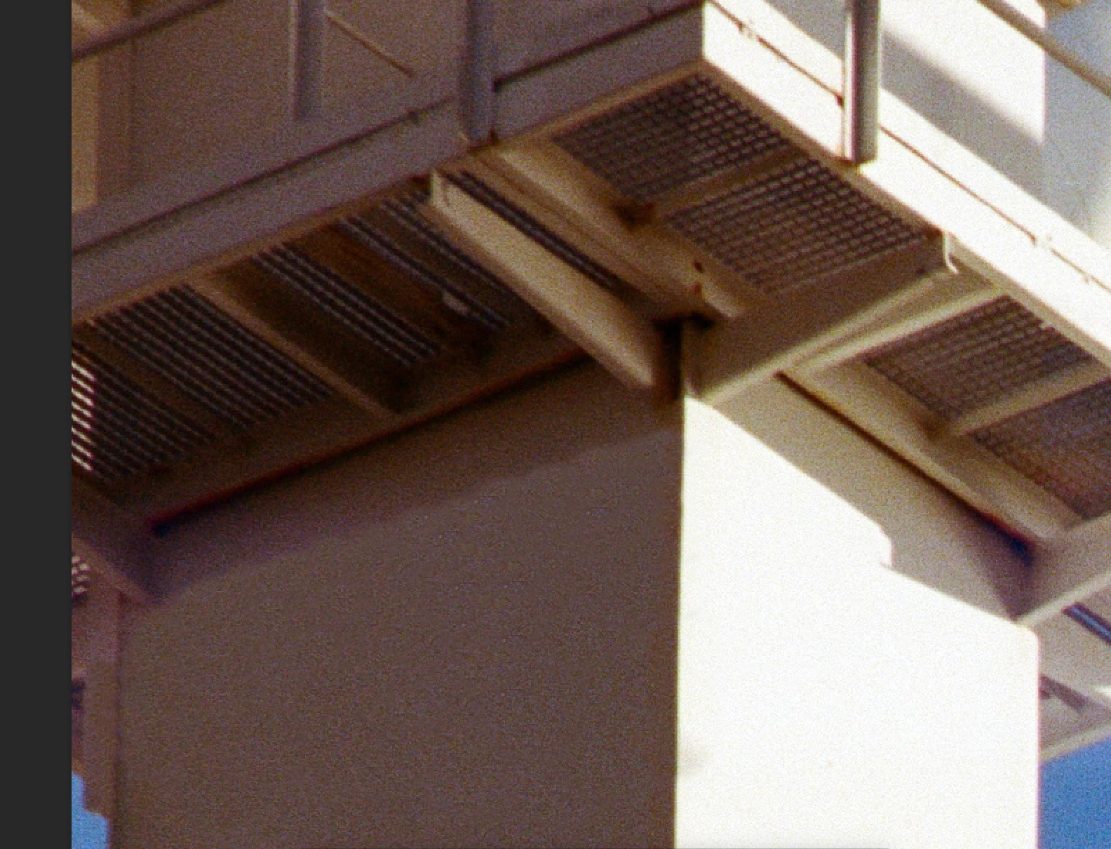

Sometimes after doing some clone stamping, I end up with some unwanted borders/edges between different colors. How can I fade the color from one to the other, so that the edge/border is no longer obvious?

Sure! I'm wondering about this in general, but I'll put an example.
In the attached screenshot, you can see a column (appearing very grainy, as this is a closely cropped excerpt from a film photo scan), and on the dark/shaded side of the column, I did some clone stamping to remove a streak of color I wanted to get rid of. Since I was cloning bits of texture from below the part I removed, and the column gets darker at the top, there's now a clear border where I stopped clone stamping.
Is there any tool I could use that would let be fade between these two shades somewhat, to make that border subtler?

There are a number of ways to do that, but I feel that you're fixing the wrong problem, because there are other ways to remove the unwanted streak of color (content aware fill, generative fill, frequency separation using the mixer brush, perhaps even the patch tool or healing brush), that would do a better job than the clone stamp.
That said, one fairly simple way to tackle what you have now would be to copy a section of the column immediately below the dark patch onto a new layer, make it a Smart Object and set the blend mode to Lighter Color. Apply enough Guassian Blur to get a nice blend, then mask off what you don't need. Finally, add back enough noise to match the grain.
Another might be to make the dark and light into your foreground and background colors, add a layer, make a selection around the area where you want to smooth out the color, fill with the gradient and experiment from there to get good-looking result. You'll then want to add noise, as before.
If you're up for some experimenting and you like to be hands on rather than leaving it all to an automated tool, definitely look into frequency separation retouching for this. There were three sessions at MAX 2020 covering the technique in depth. The link I gave is to the first one, from where you can find the rest.
