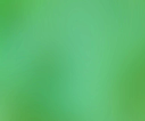

When heavily blurring an image I get unwanted ghosting or artifacting. That looks like stepped ghosted outlines of the areas with varying saturation and/or darkness/lightness. I've had this occur using all the blur options available (except Average). And my best results so far have been using the Field blur in the Blur Gallery. This is a cutout of an image where the problem is quite apparent. Anyone know what I'm doing wrong? I am working on documents which are 300ppi at various sizes.

I am wondering if we could have had a better idea of what is going on if we'd seen more of the image, and we knew what settings you are using?   Is this being done on a full layer, or are there any selections active?
I am also wondering what zoom ratio your screen shot was taken at?  It appears to have large clumpy noise, which suggests a high zoom ratio.  Show us a screen shot showing the entire workspace with the layers panel and maybe the history panels visible, and pasted here at full res.

D Fosse
September 2, 2017
Unless you have a 10-bit capable monitor/video card (very few do), you will always see some banding on screen. An 8-bit display system only has 256 discrete steps from black to white.
If that 8-bit banding is very irregular, there is an additional problem. A low quality panel or a faulty monitor profile will make it worse. The most common cause, however, is calibration tables in the video card. Do as much as possible in the monitor's OSD controls, so that video card adjustments are kept to a minimum.
In short, any banding you see in a 16-bit file is in your display system.
c.pfaffenbichler
September 1, 2017
Good to see someone not trying to blame anybody else right away when a problem arises.
But you probably have just stumbled on the limitations of working on 8bit images.
I would recommend two steps to try to alleviate the issue:
• Work in 16bit. You would have to redo the blurring unless it has been applied as Smart Filters anyway.
• Add Noise after the blurring. This could be done as a (Smart) Filter or with a Pattern Layer or Pattern Overlay of the appropriate noise set to Blend Mode Linear Light (and possibly reduced opacity).
