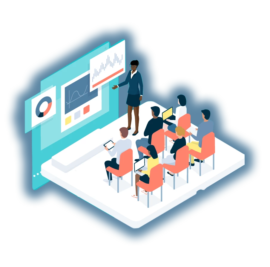

I'm trying to export a set of images using the 'Layers to Files' function. These images have drop shadows, and when I export them in this manner, they are not transparent. There's a thick, white border around the shadow.

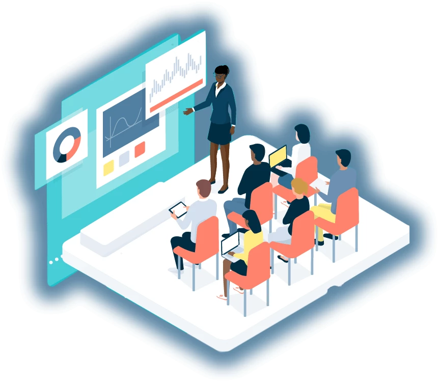

On the other hand, if I export the layers individually using the 'Export As...' function, the drop shadows are transparent. Of course, this means I have to do each layer individually, which takes a little more time.
I'm sure there's a setting I'm missing, but I can't figure out what that is for the life of me.
Examples are attached.

When you use Export>Layers to Files are you using PNG-24 with transparency checked?
It looks like from the example file you posted that your using PNG-8 which will give the results your seeing from Export>Layers to Files.
You want to use PNG-24 for transparency in the shadow.
