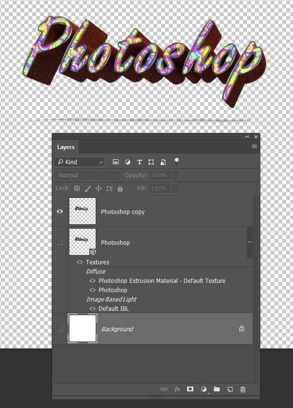

    Trevor.Dennis
    May 1, 2017
    I am not an expert with Photoshop 3D, but try selecting something other than the Move tool to make the ground plane etc. disappear.  Now this may not be the right way to do it, but if you copy the 3D layer and rasterize the copy, you can save that as a JPG, or turn off the background layer, and save a PNG with transparency.    We'll see if our davescm  can give you a proper answer.
