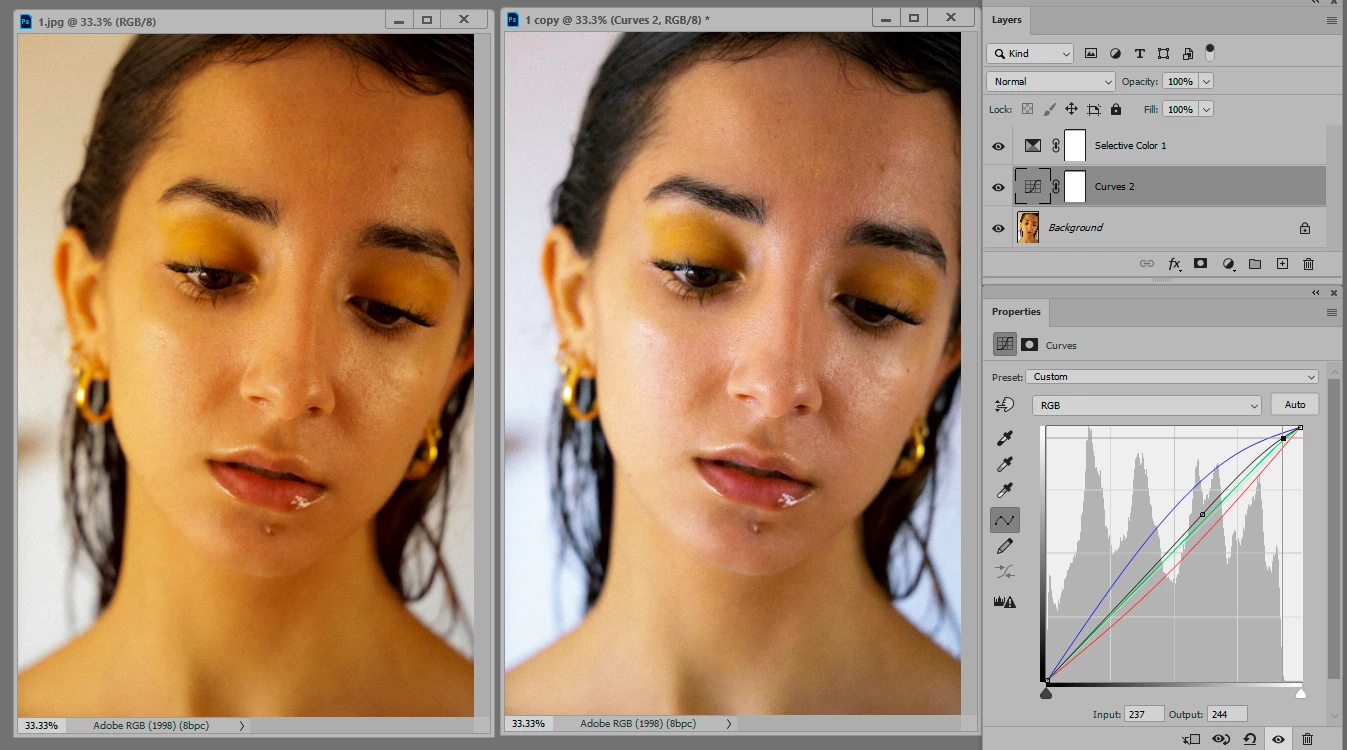

Here's how I would do that:
The Selective Color layer above is just to reduce the blue in the background a little bit.
EDIT: OK, maybe pull back a tiny bit on the Curves layer. Maybe that's just a tad too caucasian...
