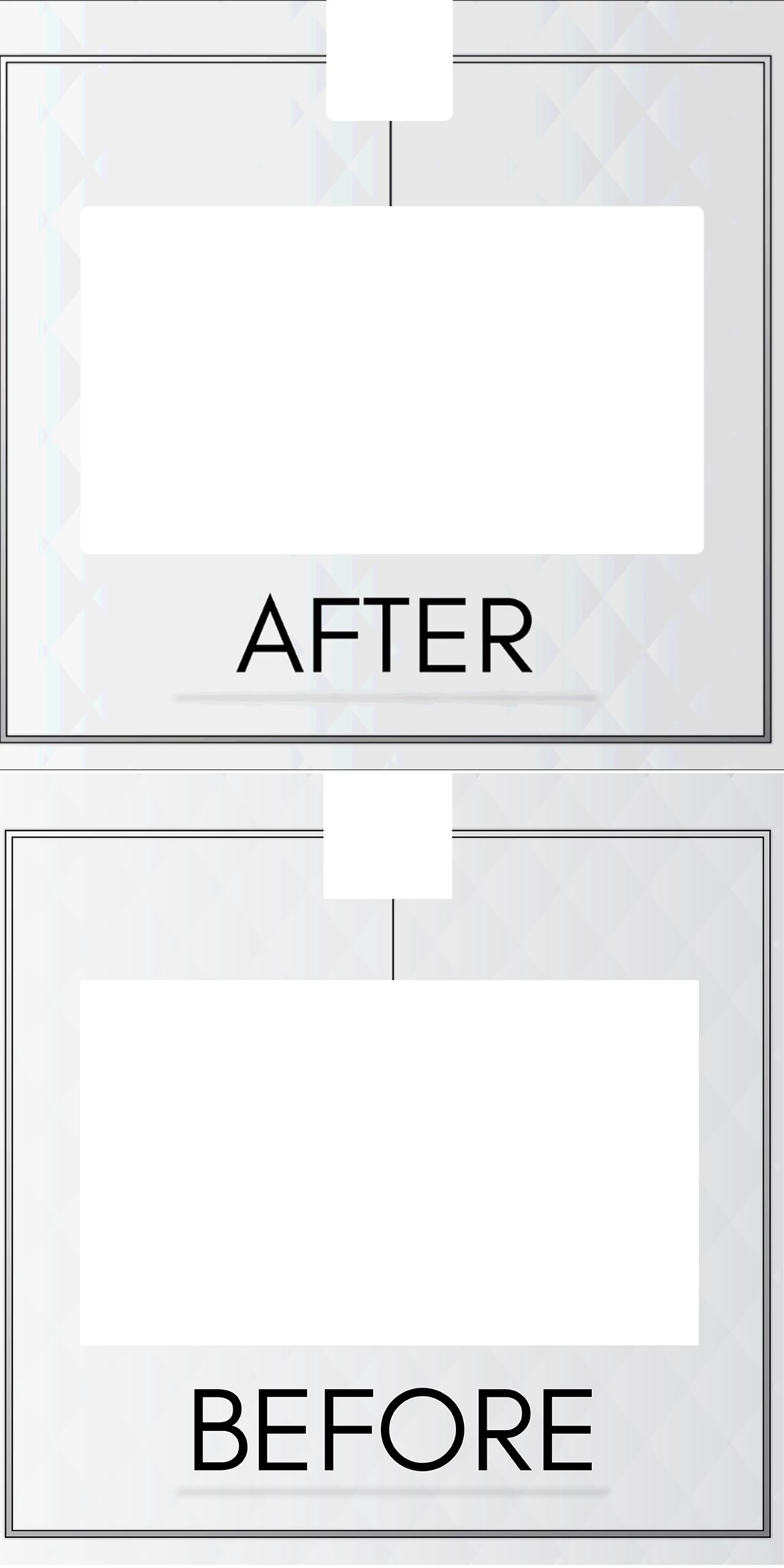

why do pattern swatch color change when i transfer the file to GIF? any solution plz?

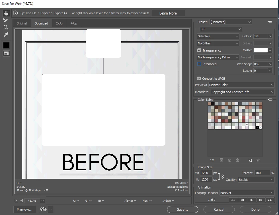

    The screenshot in #3 isn't understandable. The palette colors have very little relation to the image colors.
    Is the shown image just a small part of the whole image?

    How exactly did you create the gif (Save As, Save for Web, …) and with which exact settings?
    Where are you viewing the resulting gif?
    Please set the Status Bar to »Document Profile« and post more meaningful screenshots of both the original and the resulting image.

    - i used save for web....

    Why only 128 colors?
