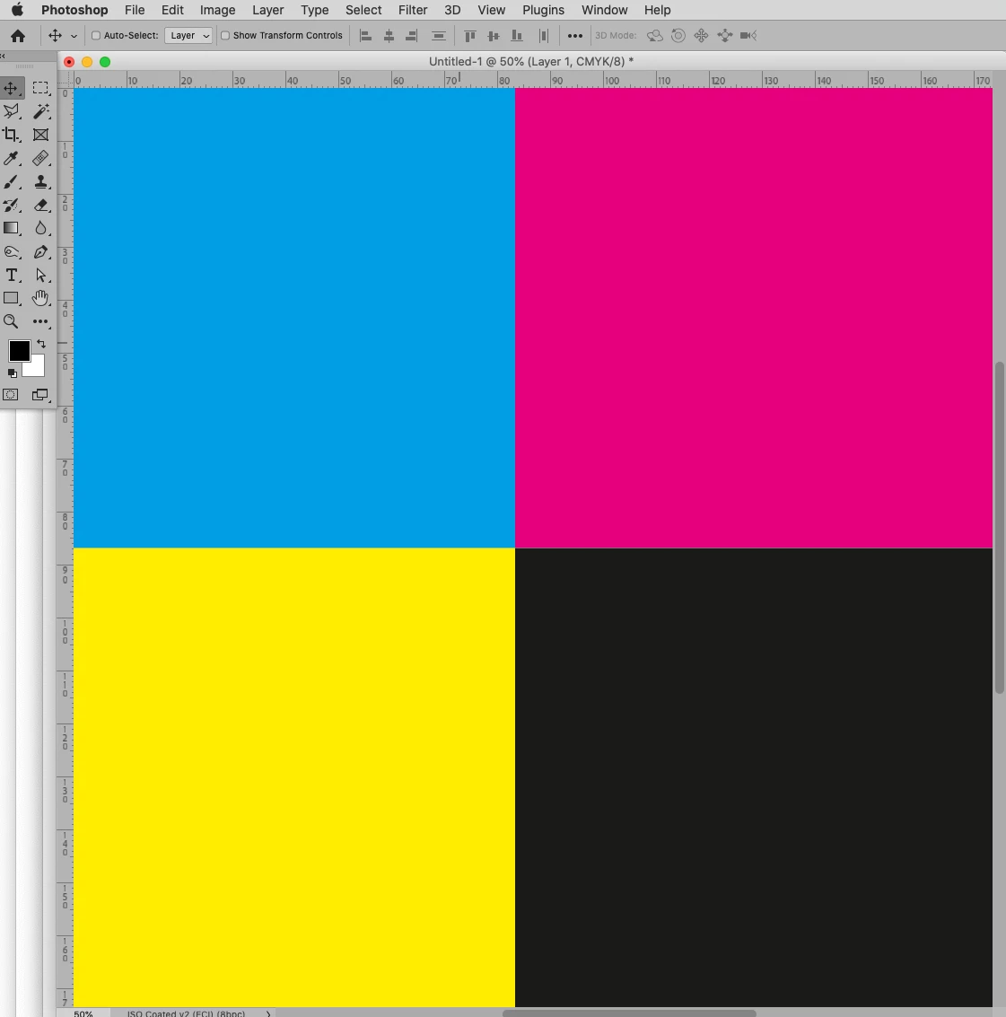

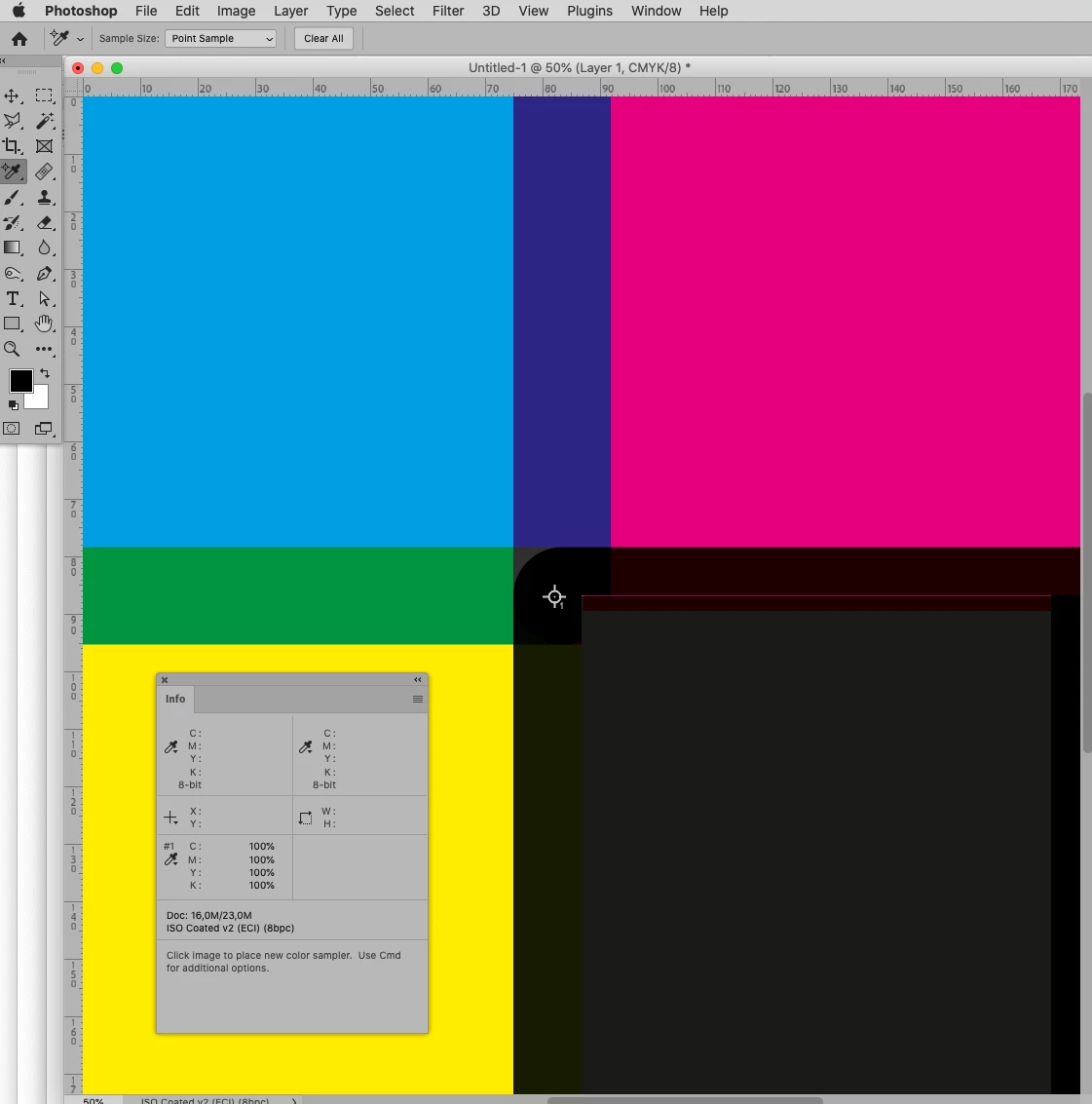

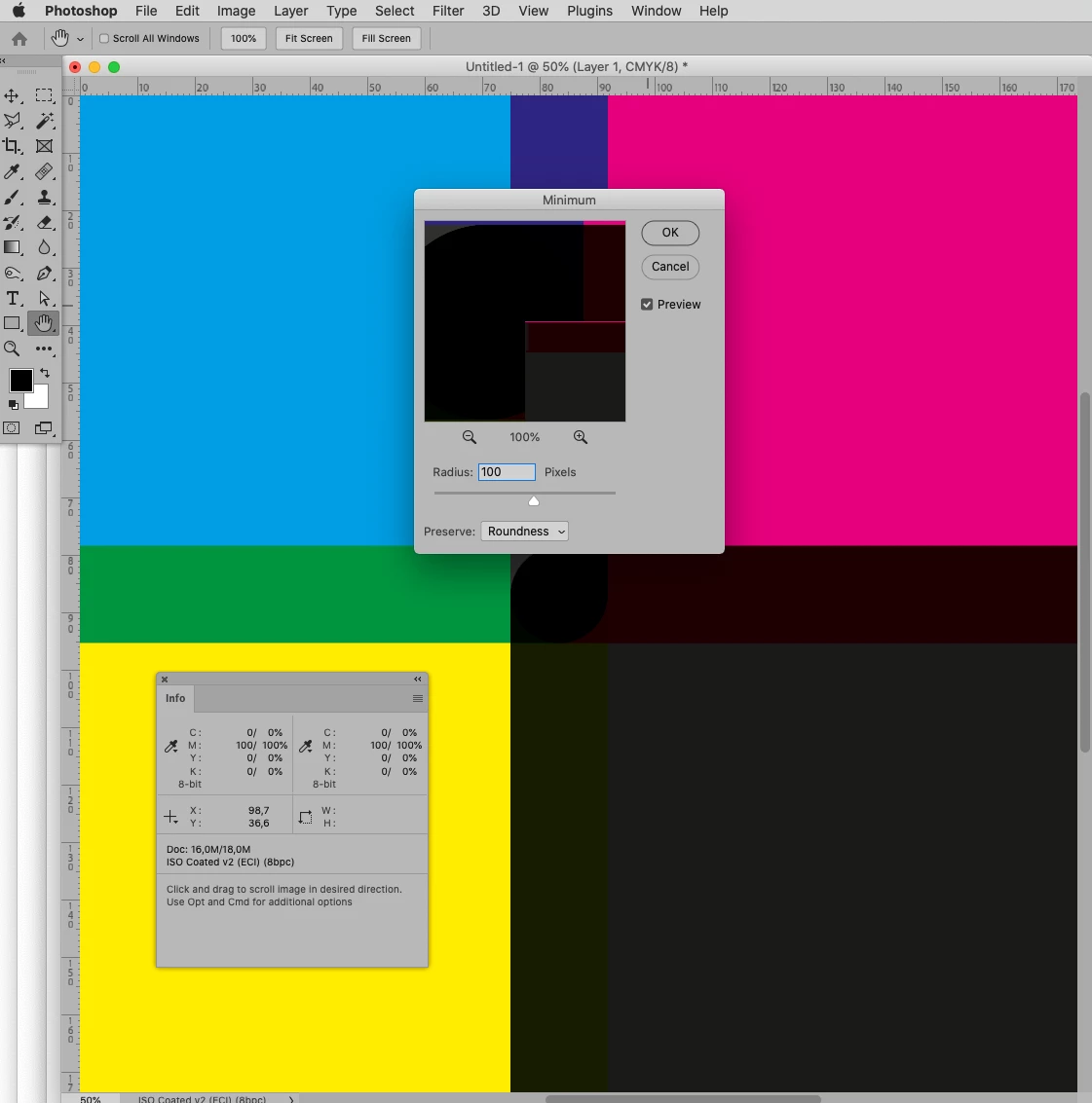

And to avoid violating a CMYK Space’s limitations (TAC in particular) some Filters would need to incorporate Color Management …
Filter > Other > Minimum for example works in CMYK but it can easily cause areas of more than the admissible Total Area Coverage.
