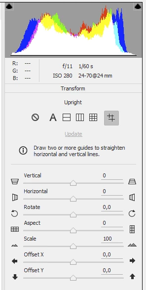

    Per Berntsen
    November 3, 2016
    Have you tried Guided upright?
    Draw lines along two edges you want to be vertical, preferably one on the left side and one on the right side of the image, and the image will straighten.
    It works very well for me, much better than the Auto option.
