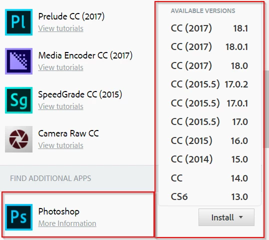

    Hi Judy.  Creative Cloud has a facility to install Previous Versions which means CC 2014, CC, all the way back to CS6
    Because CC does not differentiate between Standard and Extended versions of Photoshop, CS6 defaults to the full version.  However, I have not heard of an existing perpetual licensed CS6 being affected.  CS6 Perpetual License, and CS6 via Creative Cloud, are two separate entities with an entirely different installation process.  So are you saying that your original installation of CS6 has changed, or did you install it again from the CC Application Manager?
