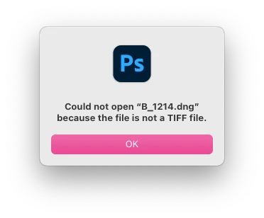

Why is Photoshop telling me the following error message "Could not open "B_12XXX.dng" because the file is not a TIFF file" (see attachment).
He is speaking about TIFF files!!!

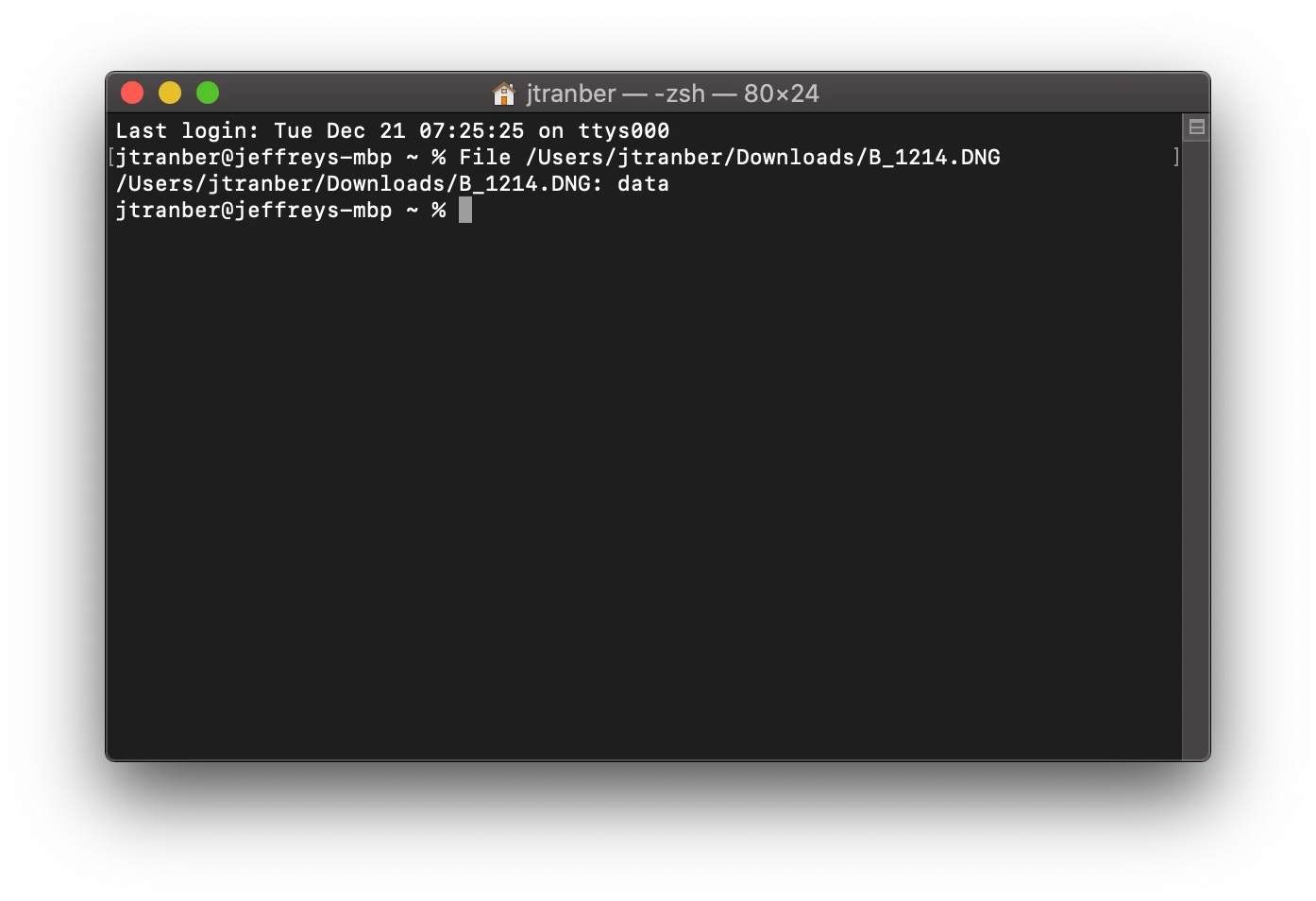

It appears the DNG file is corrupt if I try to determine its file type: https://helpx.adobe.com/photoshop/kb/determine-the-file-type-of-a-document.html

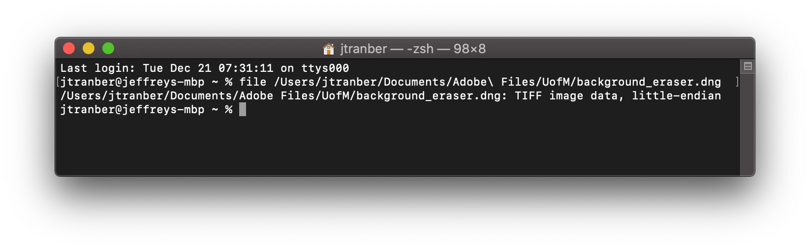

DNG is an extension of the TIFF 6.0 format. A good DNG looks like this:
Data corruption usually occurs at the hardware level, either a card reader, drive, connection/cable or network connection. That's where I'd start.
