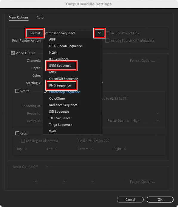

I forget how it worked in the past, but today, because Composition > Save Frame As > File adds the job to the Render Queue, the final file format is set by your Output Module settings. When you open the Output Module for the current job in the Render Queue, you can then change the Format to anything in the menu, and then start the Render Queue to actually run the job.
Even though it says Sequence, if you used a Save Frame As command it’s only going to render one frame.
