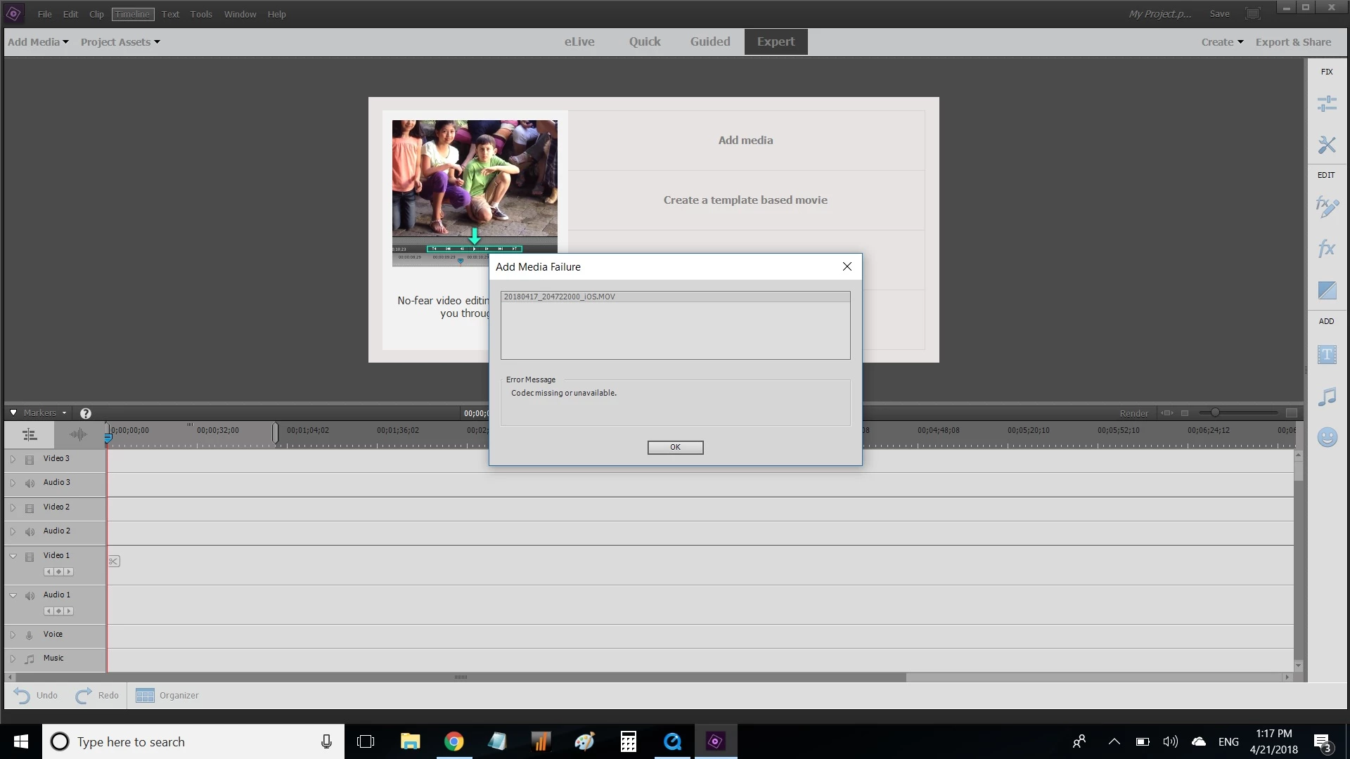

I installed Quicktime. Am I supposed to do something with it after I install it?
I tried importing the file again. This time I cannot even import the file, I am getting a "Codec missing or unavailable error":

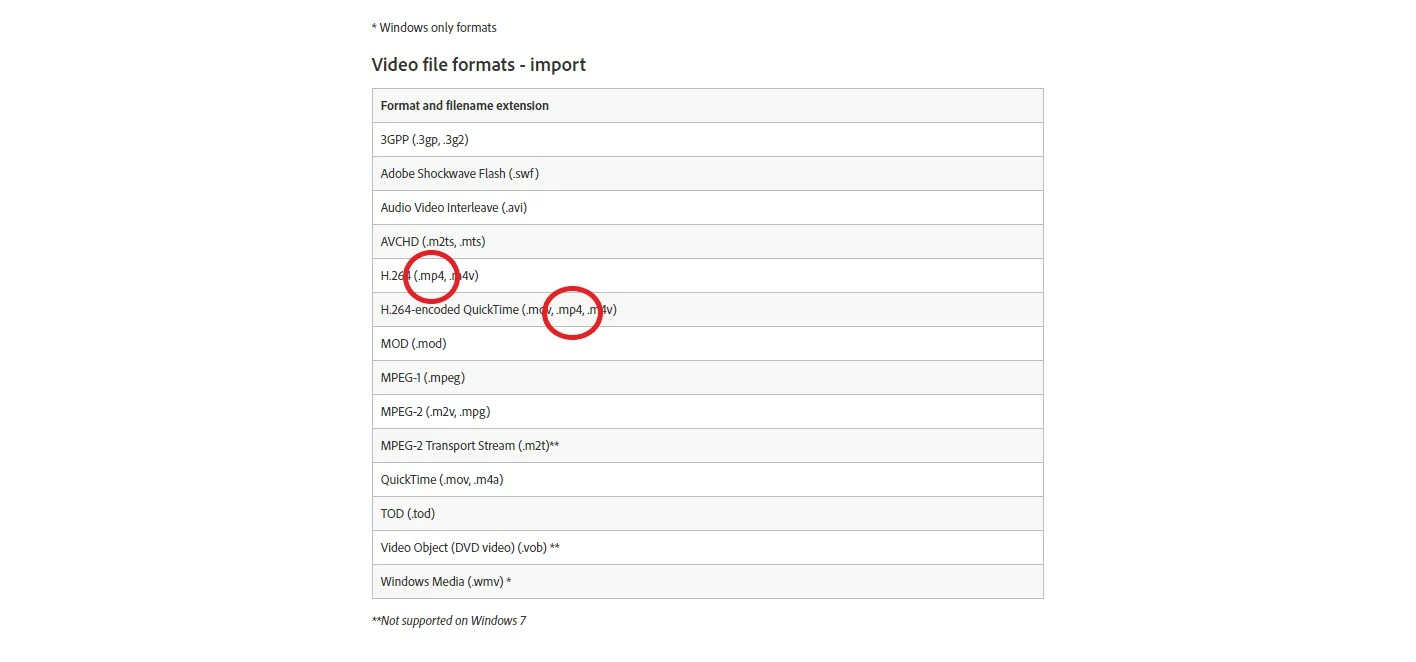

Since I posted this I discovered something major. And that is that Adobe Premier Elements 2018 doesn't support mp4 video file formats (which is the iphone video file format): Supported file formats in Adobe Premiere Elements
I don't mind providing all other info but can you or someone else advise if there is any workaround this? I would like to be able to import directly into Adobe Premier Elements 2018 without converting the files. I used a converter and it works but it takes time and is a hassle.

Premiere Elements DOES do MP4 files.
