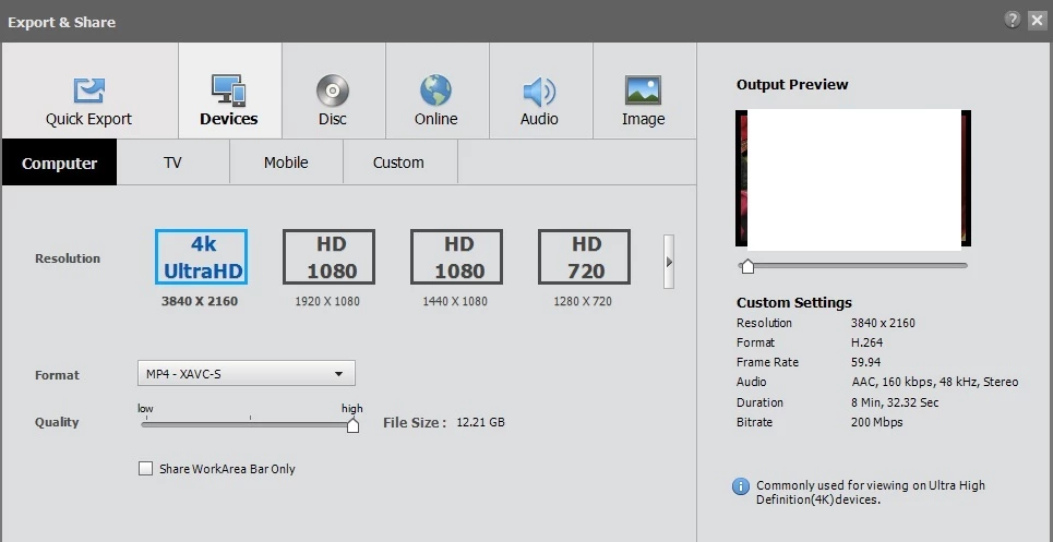

Adobe Premiere Elements 14 - exporting 4K but generating 500mb small file
I haven't used Premiere much as bought to use Photoshop but lately GoPro Studio trial expired and I am back to other options thought I should give Premiere a test on combining clips.
I tried exporting with the following configuration, 4K 200mbps and file size 12GB see screenshot included.
For some reason Premiere is exporting a low quality 500-600mb file, including full 8 mins of video but not the 12GB file. A very low quality version that cannot be used anywhere.
Can anyone tell me what I am doing wrong and how I can fix this?
Thank you!

What does the bitrate say of the 2nd file?
Might want go into Custom and set up a custom export.

Got it working with Custom Export copying Source Format.
For some reason Premiere didn't like the standard 4K Export option.

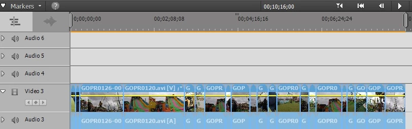

Apr 8, 2018 11:41 AM UTC
Set workarea bar over entire timeline and check it in the export settings.
Apr 8, 2018 2:58 PM UTC
Isn't this the Work Area Bar?
Seems to be on the required time length?
