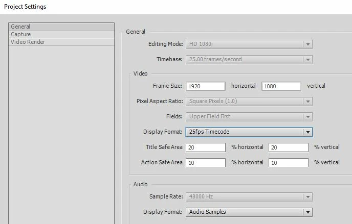

I have only just started using Premiere Elecments 2020 and have noticed an issue with a couple of the final productions after render has completed.
When viewing the rendered video it would appear that the video camera was bouncing during filming, but it wasn't. If raw footage from camera in viewed on PC it is perfectly stable. Camera was set up on tripod on tiled floor. I have done several videos using same camera/same location/setup without any issue. Have only noticed this is two videos, the latest being yesterday.

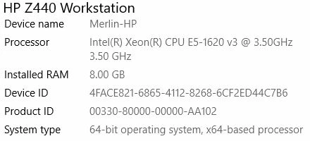

My system is as follows.
Video camera is a Sony FDR-AX33
REC Mode - High Quality
Frame Rate - 50i
File Format - AVCHD
Premiere Output Settings
I have noticed that during rendering my processor is running at 97-98%.
I am only a beginner at this and am basically using all default settings in Premiere.
Thanks for your assiatnce if you able to help out.

Jun 22, 2020 12:12 PM UTC
It looks like your program is properly set up to match your video specs.
Assuming you're using one of the standard Export & Share templates, I don't see any reason you'd have any problems with your video.

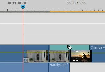

Jun 21, 2020 12:52 PM UTC
When you first add one of these video clips to your timeline do you see a yellow-orange "render" line above the clip on the timeline? This is a test to see if the program is properly set up to match project settings with your video specs.
Kevin4870Author
Jun 22, 2020 9:41 AM UTC
Hi Steve,
When I look at the "render line" I notice that it is orange only on photos and transitions inserted using Premiere. What would be my next step to finding what the incompatibility is?
