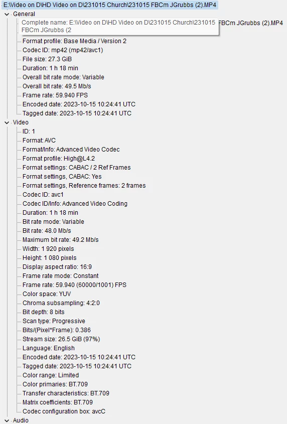

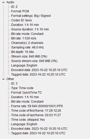

Please use the free MediaInfo and post a screenshot of the properties of your source media in tree view:

dd1947Author
Oct 26, 2023 4:19 PM UTC
dd1947Author
Oct 26, 2023 5:02 PM UTC
Here is data from week prior video. Same camera.
