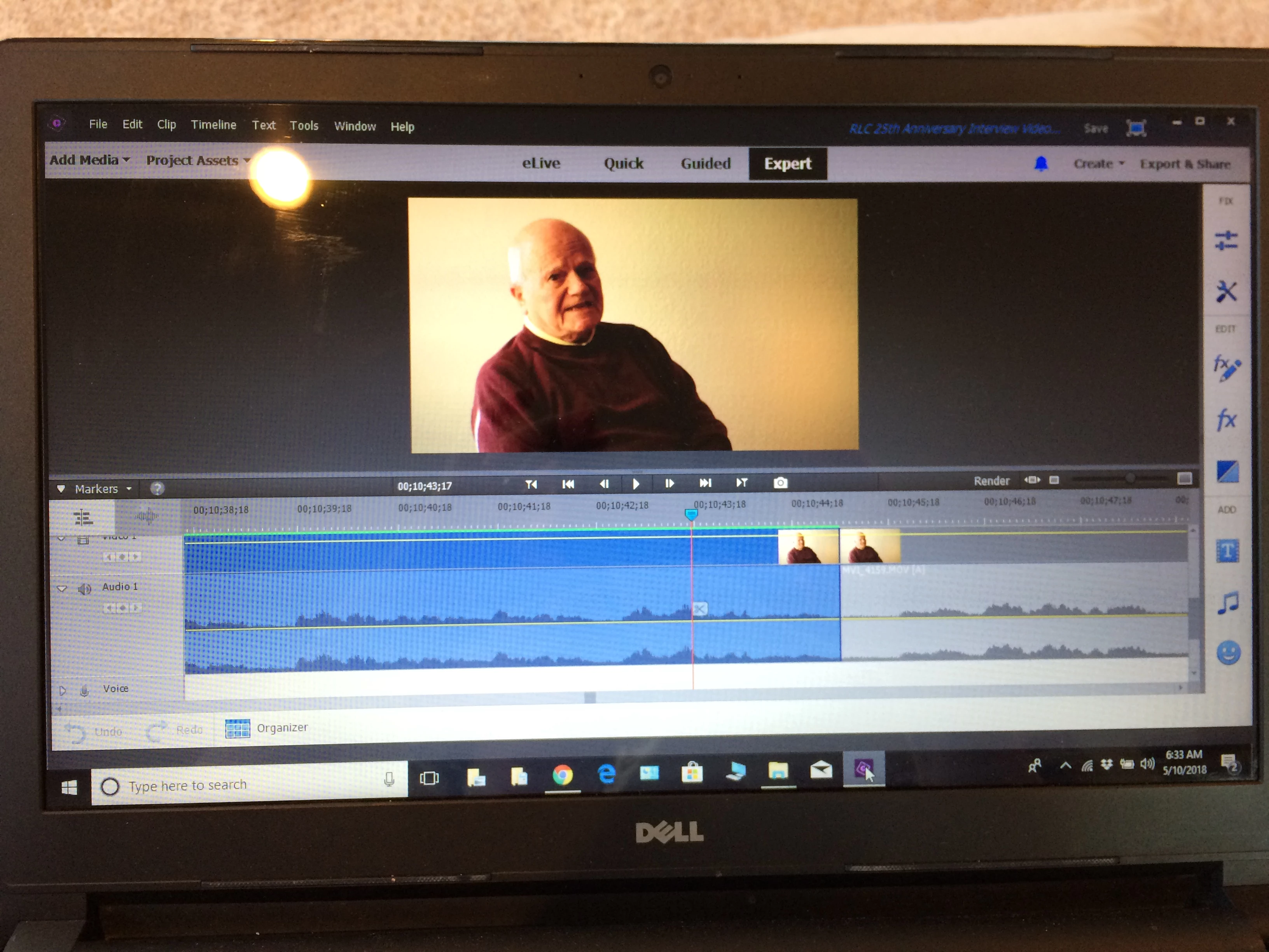

    Peru Bob and Steve Grisetti, please disregard my responses above.  I realized that when I reopened, I brought up an earlier version which was why the gray was gone.  So, I still have the problem. Also, notice that the Undo/Redo buttons are grayed out as well.  I'm stuck right now as I don't want to move forward without fixing this issue. Here is a screenshot of the section that I am referring to.  Thanks in advance for any help for this newbie! I am extremely grateful that you guys take the time and share your knowledge to help us!

    Ugh! I am just a little frazzled and frustrated by now. Here is the screenshot

    May 9, 2018 11:31 PM UTC
    Can you post a screenshot of your timeline?

    May 10, 2018 1:29 AM UTC
    Re #1, right-click on the clip on your timeline and check that it is Enabled.
