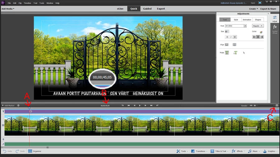

    With Premiere timeline I can't find anything special things. Here's screen capture of timeline between 45s05 ... 47s00 and I have marked with red arrows to screen capture few things:
    A) Cursor shows time before last blink
    B) It is  00;00;45;05
    C) Timeline's "Zoom" has maximum level
    What I can try to search next?
    Ann Bens
    Aug 2, 2017 12:29 PM UTC
    Remake the title or...
    Remove still from project.
    Resave in Photoshop,
    and rename the still.
    Then try again.
