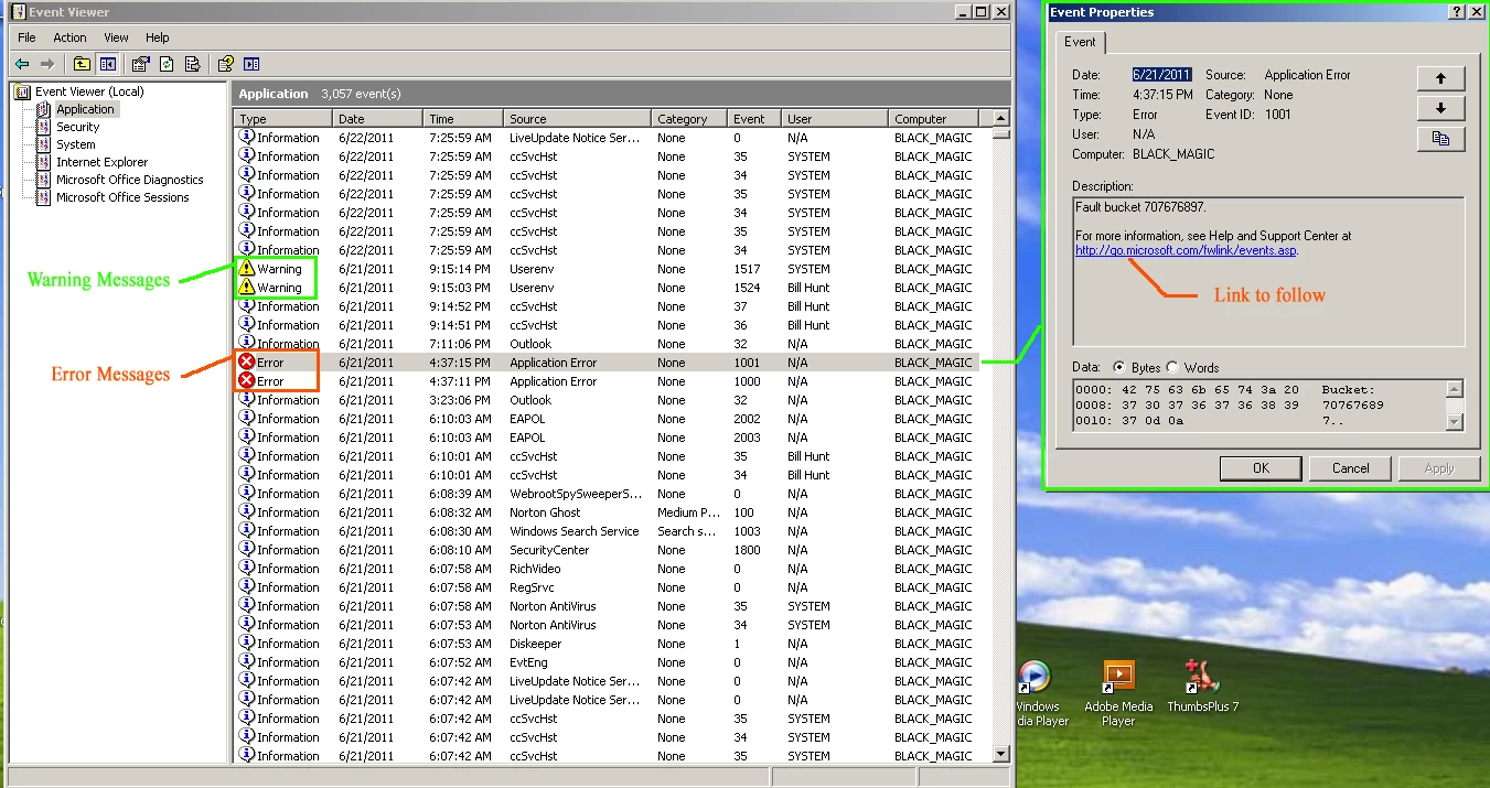

Often, one can track a BSOD down, and especially if it's a bad, or corrupt driver, by using the Event Viewer.
Here is a look at the Event Viewer from XP-Pro, with some error and warning messages, and showing one error message, which also has a link in it:
Depending on one's version of Windows, the location of Event Viewer, plus the look of it, might be different.
Hunt
