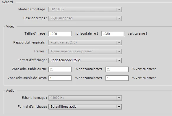

Dec 24, 2016 2:53 PM UTC
Hello !
Thank you for your quick answer.
The original video was a first export made by premiere on a other project.
I use the current project only to add dvd menu and scene marks
No orange line :
video properties :
project properties
(sorry for the french in the screenshot, but I suppose only the values are interesting )
