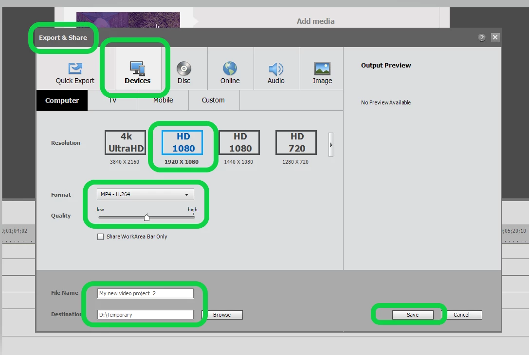

I can't remember version 12.  It used to be "Publish and Share" and changed to "Export and Share".  It should be near where you were making DVDs.  Their are options, but the defaults should take you through it.  If you can figrue it out, post some screen shots.   The current version looks like this:

Okay this is what I have tried I went to Publish and Share in PE 12, there were several options to choose from and I tried 3 different formats
         1. Computer under computer it gave me
  • Adobe Flash Video     I tried this format and it gave me a F4V file and I could open it with Windows Media Player but when I played it, it did not fill my TV screen properly. I had a white line at the top and the bottom and there was black showing on the sides. However I thought that the slide quality/resolution was improved over my burned disc  I did not try the other two
  • MPEG
  •  AVCH                                                                                                                                                                                                                        2. Mobile Phones and Players
  • Apple iPad widescreen high quality, I tried this one and it gave me the MP4 file but I did not feel that the quality was any better than my burned disc
  • Apple TV iPad iPhone 4,  1080p 29.97,  I save it under that and again it saved an MP4 file and when I played it back again using WMP I was pleased, it filled my screen same as a burned disc, but I felt that now the picture quality was sharper (better resolution) than my disc
So all of that said there is something about having a burned disc that I like but if it is going to be a thing of the past than saving it as the last option seemed to give me the best resolution and play back. Unless of course Windows Media Player decides not to cooperate.
The only thing that I did not like was that none of the menu features, play and scene selection etc.  were there under all 3 of these formats. Is there any way to have them replicate same as on a burned disc? That to me makes it appear more professional.
Thank you for your assistance on this project, I feel that I have made some progress but still may pursue why my HP will not burn  a playable disc for my DVD player.  Thanks again
