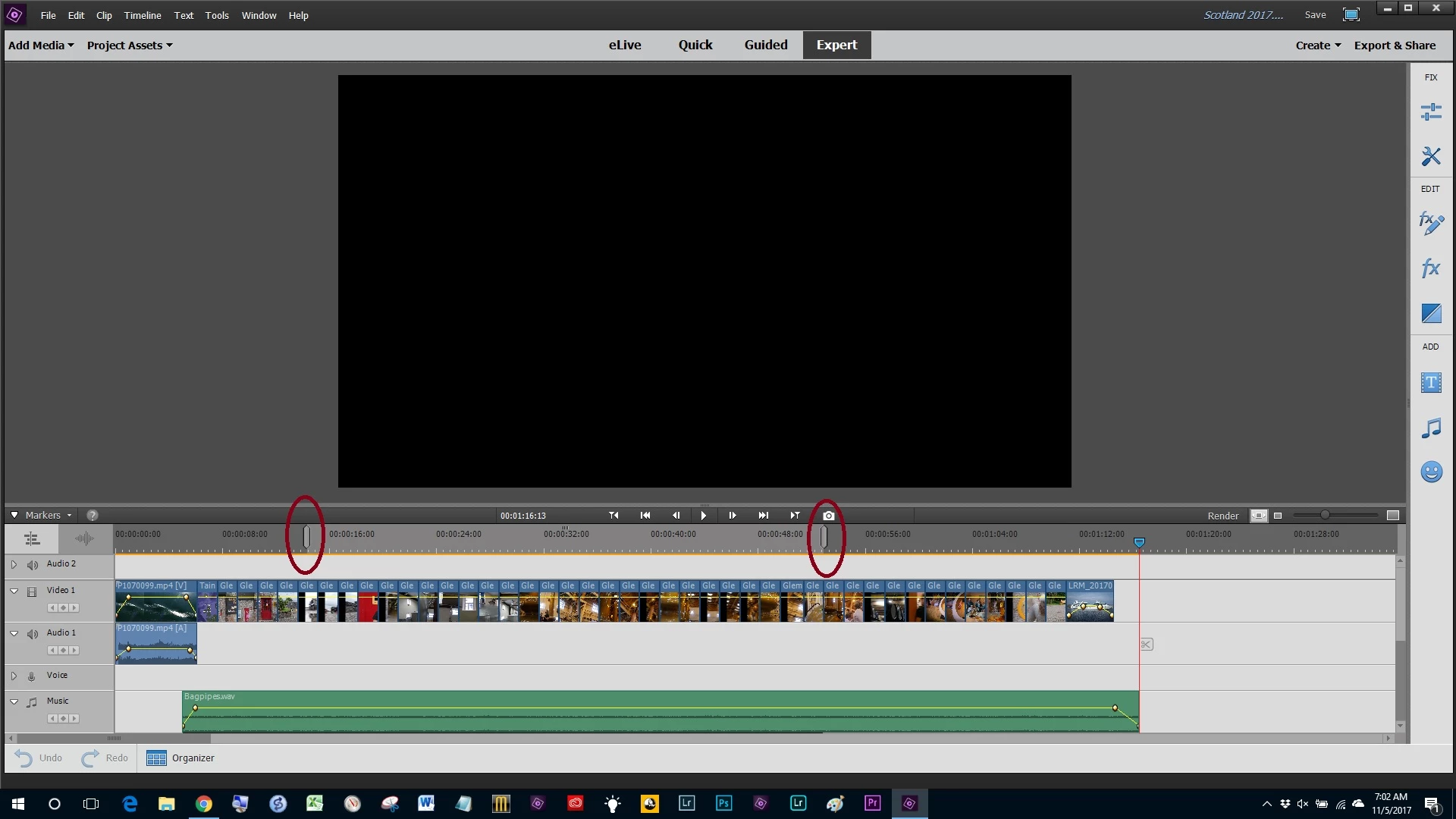

    You can set the work area bars at a section and export only that section into new clips that can be used in other projects.

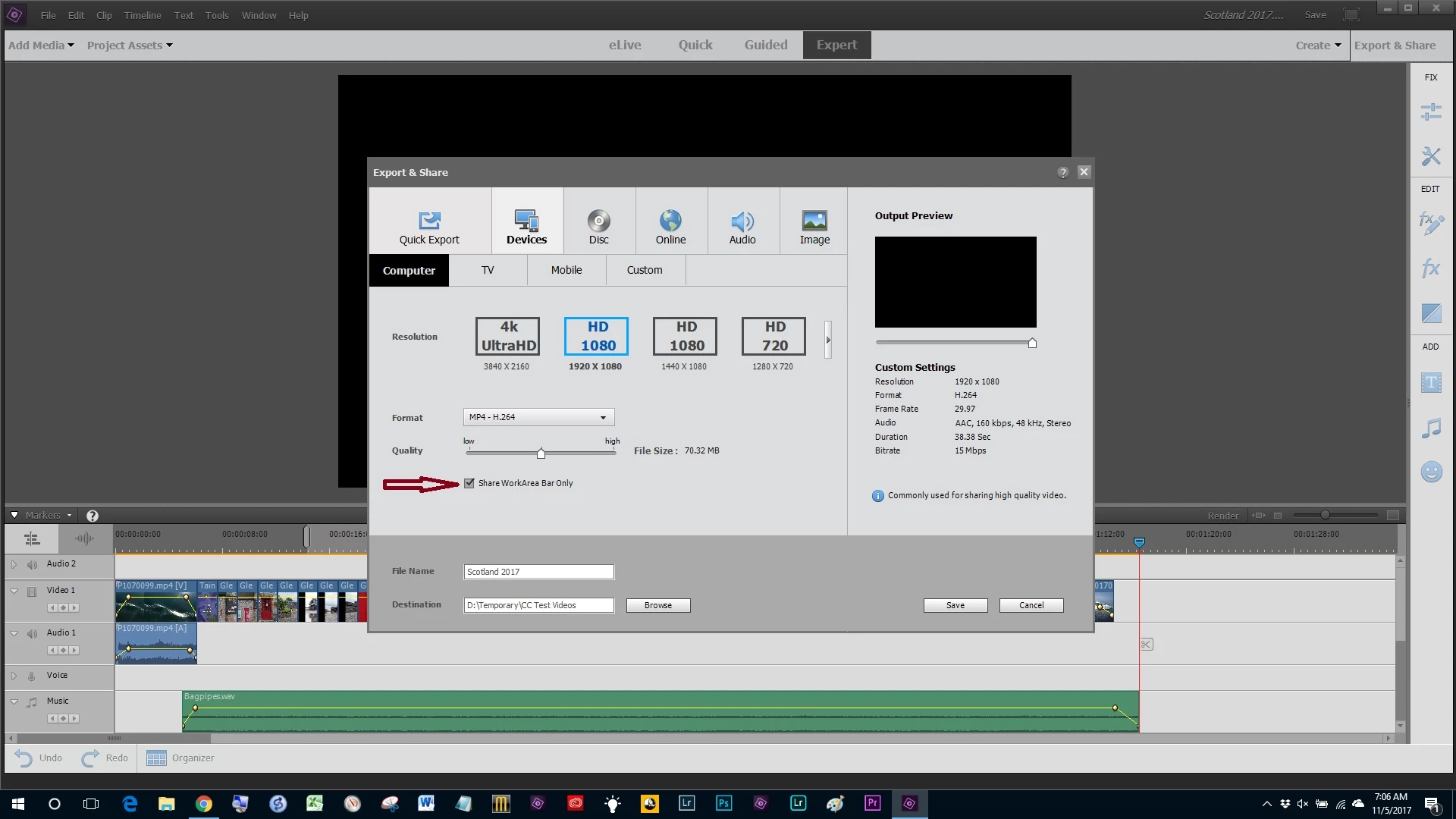

    You slide the WorkArea bars above the time line to match what you want.  Then at export you check the box to save only that part.
