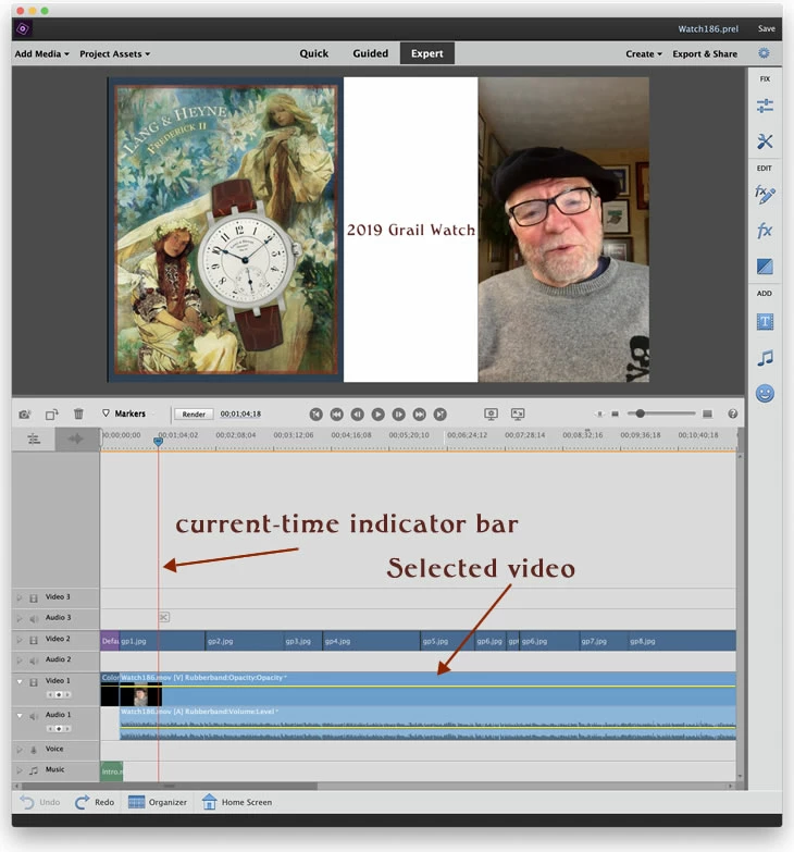

    To edit out a piece of the video, you may find it easier to switch to the Expert Mode.
    1. First find the video clip you want to cut from. Then click on it to select it. It turns a light blue.
    2. Next, drag the current-time indicator bar (sometimes called a 'scrub bar') to the beginning of the portion you want to clip.

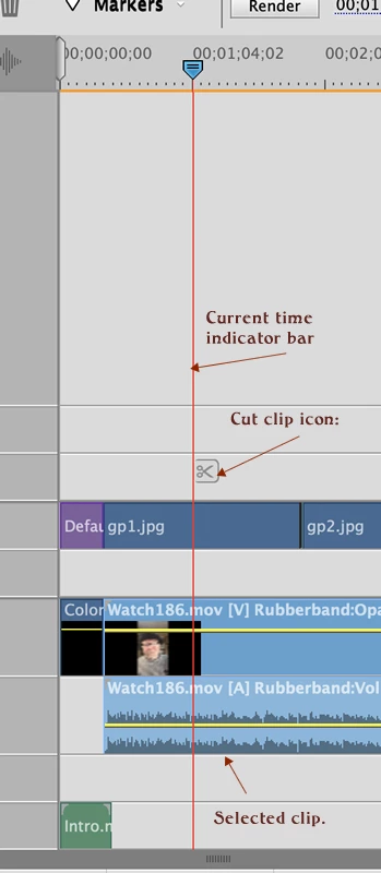

    3. On the current-time indicator bar, you will see a split clip (or cut clip) icon indicated by scissors. Click on the cut clip icon, and you will see that the selected clip has been split at the point of the current time indicator bar.
    4. Drag the current time indicator bar to the end of the portion you want to cut, and click on the cut clip icon again. Now you have a portion of the video cut on both ends.
    5. Select just the part of the  video you want to remove, and press Ctrl + X (Command + X on a Mac) to cut out the unwanted portion.
    6. Your video clip should automatically close the gap that has been cut out.
