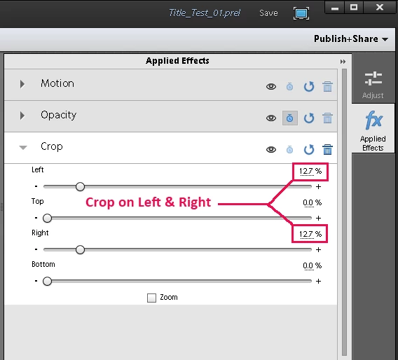

    You can apply the Effect>Crop, and adjust it to just the Left & Right (0% on Top & Bottom).
    Now, if you have adjusted the Crop, with an unequal reduction from one side vs the other, you can "center" your Cropped Frame in the Video Frame, by adjusting the Fixed Effect>Motion>Position to center it.

    Once you have applied the Crop Effect, and with the Clip Selected, go to the FX tab, to expose all Effects. Twirl open the Crop Effect (little triangle next to "Crop"), to reveal the adjustments. There, you can click on the % window and type a value, or click+scrub it, to change the %.
    Note: screen-cap is from PrE 11.
    Hope that helps, and good luck,
    Hunt
