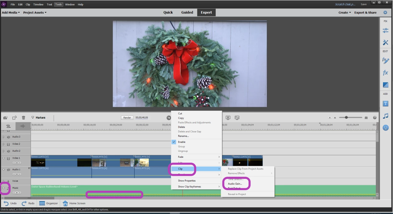

Can't reduce sound volumn
Greetings and thank for taking my question
Using elements 21.
I added music from the software music election. I cannot set the volumn lower. If I use the mixer it lowers it until I start the track again and the volumn return to original. If I press apply in the mixer, it makes no difference.
5 replies
Mar 31, 2021 5:58 PM UTC
You are using the "Audio Mixer" that is more complex than simple gain for the track.
To adjust the gain you can expand the track with the small arrow button on the left and then simply drag the yellow line up or down.  You can also right click on the audio track, select Clip then Audio Gain.

Mar 31, 2021 3:40 PM UTC
Thanks for getting back to me. I have watched most of your teaching videos, probably not this one.
I have tried placing the background music in every track. It is now in music. I see the adjustment over on the right but it reduces everything, not just the music.
Must be a way to select the track.
Thanks again.
Apr 1, 2021 3:45 PM UTC
Thank you so much..hk
