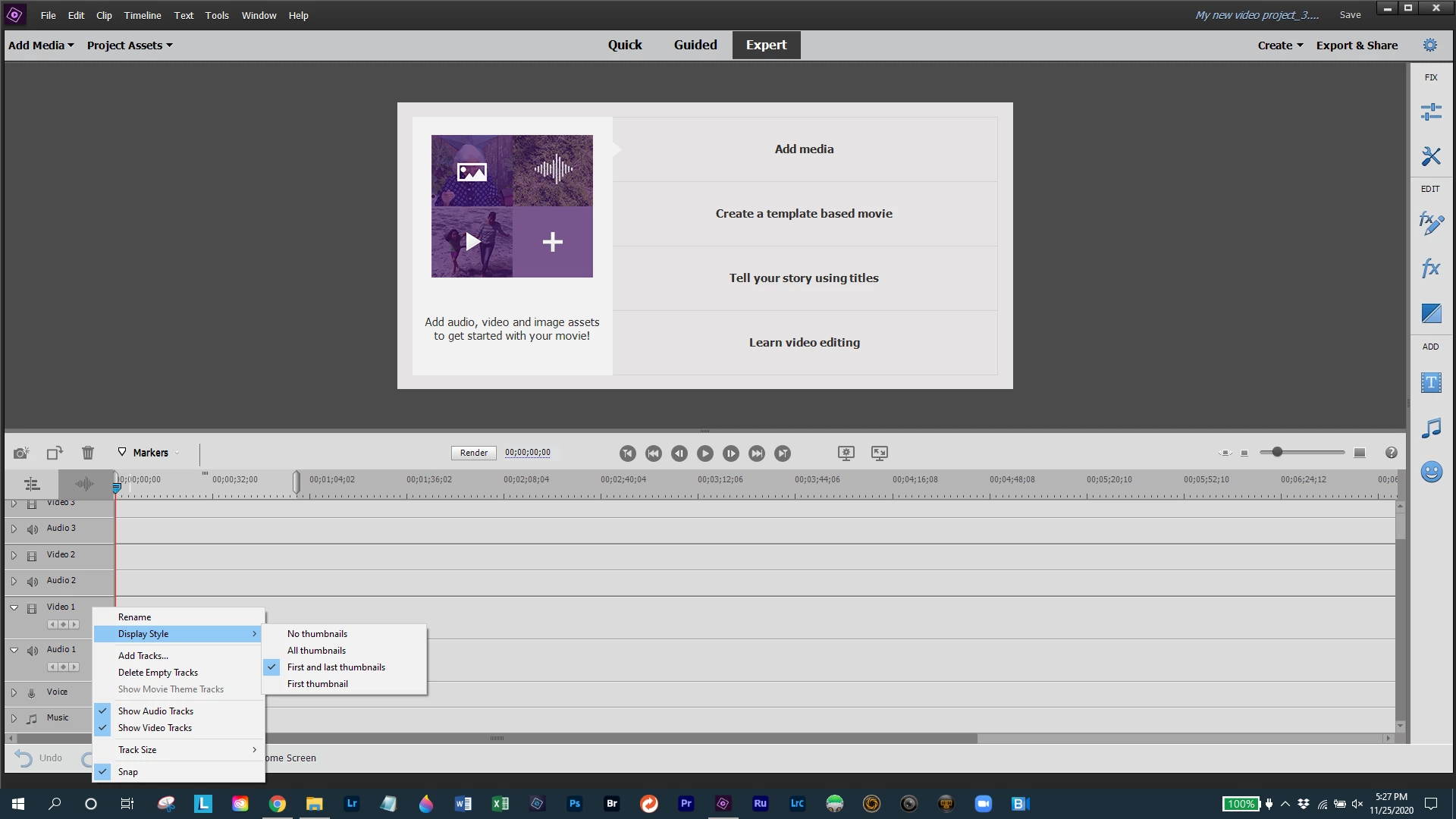

1. Right-click at the area where you have "Video 1" written (left side of the timeline where you can turn on and off the video).
2. Click on Display style
3. Choose according to your need.

Nov 26, 2020 1:28 AM UTC
Do you see these choices?

I'm in Expert mode, and I changed my audio preferences to NO INPUT as you suggested; same issue. I tried to change the display style of the video timeline with the small little "filmstrip" icon in the Video 1 panel to the left of the video timeline. It's either on (with a frame at the the beginning of the video timeline ), and a frame at the end of the timeline. when I toggle the filmstrip icon, it displays either the video style I explained above or the filmstrip is crossed out.
I used to be able to choose a display style with the entire timeline populated by video frames.
