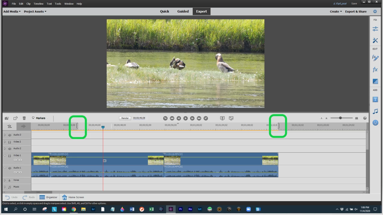

Can you export multiple trims on the timeline as individual files?
I have multiple trims on my timeline from one original file and I'd like to export them as individual files. Is this possible? Haven't found answer in Google or online help.

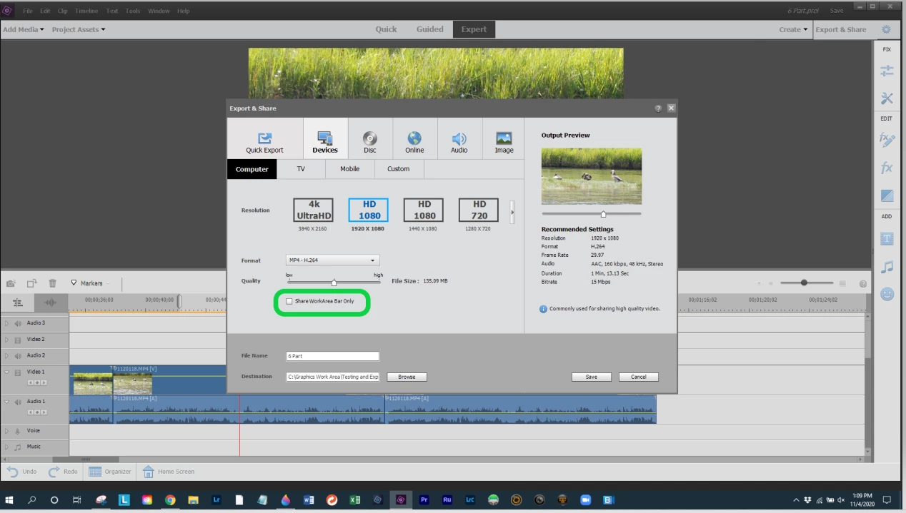

Nov 4, 2020 9:11 PM UTC
At output you have to check the box that limits it to the area between the bars.
Nov 4, 2020 9:08 PM UTC
The work area bars are at the top of the timeline and normally 'docked' at the ends of the project.   I moved mine for a screen shot.

Nov 4, 2020 8:34 PM UTC
In Premiere Elements you can set the 'work area bars' anywhere on the timeline.  Then, at export, there is a check box for "work area only".
Setting the work area bars is done by grabbing them with the mouse or by putting the CTI where you want and pressing "ALT+[" or "ALT+]".

Nov 4, 2020 8:50 PM UTC
You are the best. However, I don't know where the work area bars are. I'm in Expert mode and on my timeline but I don't see anything that looks like it is the 'work area". Please help.

Nov 4, 2020 9:09 PM UTC
OK, I think I found the work area bars. Originally I coul donly see one so that's why the "area" didn't make sense to me.
