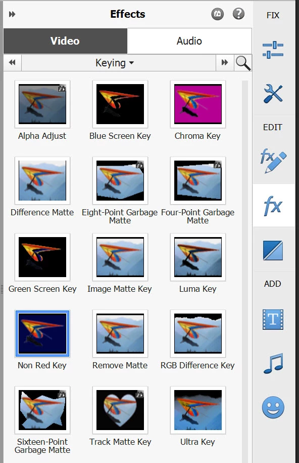

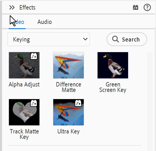

Chroma key and others disappeared from my Premiere Elements 2024
After installing the program all worked well including the Chroma Key. The following morning suddenly many key functions disapeared from the available selections of functions. Maybe due to an update of the software that was done at night. I reinstalled the purchased version and the function did not come back. I had to go back and use the 2022 version that I had earlier,
I am using windows 11 PC and curently not using the 2024.
Emailed support and they asked for the serial number, which I sent back a few days ago. Hope to get a solution soon.
Attached are a couple of screenshots shwing what is availablke in version 2022 and what is available in version 2024.
If anyone had a similar problem and solved it I would like to do get advice.

Hi @efraimp no effects were removed in PRE 2024. This is a bug which has happened in last couple of weeks and we are diagnosing this to offer a fix.

The Manual is misleading, as it is still on 2022: many effects have been removed from the 2024.
Ghosting has been dropped accidental too.
No idea when of if this is going to be restored.

Looks like chroma key has been dropped from the program as many other effects were dropped from 2023.
@Steve Grisetti the strange flag means the effect is gpu accelerated.
