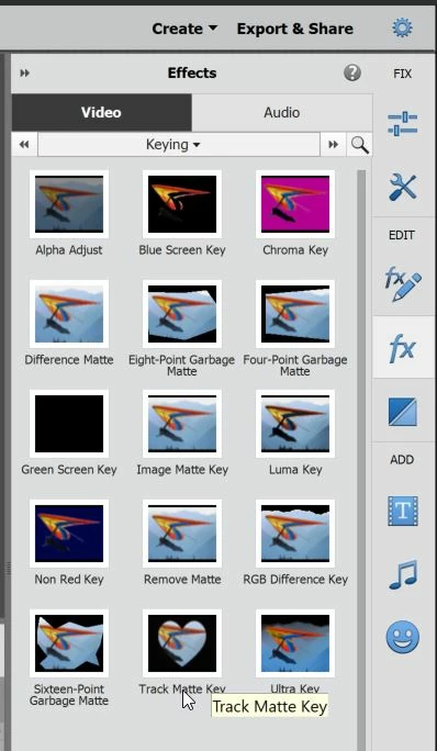

    Thank you for all your comments and suggestions. Unfortunately, the problem with 'Green screen key' persists. I've taken a snapshot of the 'Keying' panel on the right. You can see that all the others appear normal with symbols within the boxes EXCEPT for the Green Screen Key. It is all black and no symbol. Definitely a bug. Will Adobe fix it soon? Do I need to inform them? Otherwise I will have to ask for a refund and buy PE2019 as it's urgent.
    Oct 15, 2019 11:55 AM UTC
    This is a problem in version 2020 that Adobe is aware of -- though I don't know if it will be addressed. I recommend using Videomerge, as in the tutorial I linked to above.
