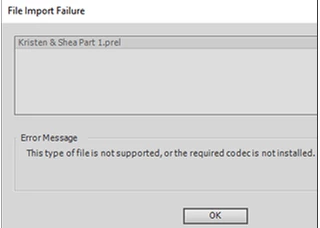

Hello- I have Premiere Elements 2021 and have been able to succesfully edit, however when I attempt to open the file the next day, for example, the file import failure error message below pops up.
I've read elsewhere on this form that installing Handbrake can help, which I've tried, but it doesn't seem to do anything with my edited project.
Could this mean that I have to start the editing project from scratch?

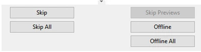

Also, I had saved the project to both my hard drive and an external hard drive.  When I open the project from the external hard drive I get the following...
...and ignoring it, if I just X out of the folder, it takes me to the PE timeline where everything looks fine to proceed.  I just don't get it.  Anyone know what I'm doing wrong?

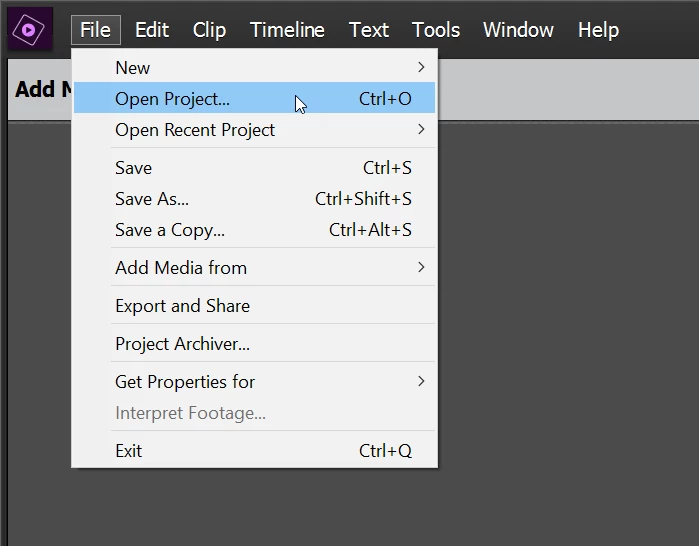

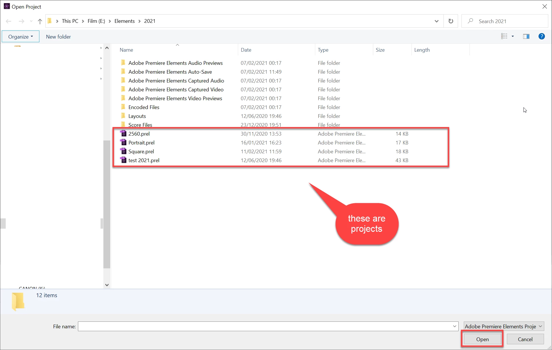

You are trying to import a project into the program which you cannot do.
Go to File and hit OPEN.
Navigate to your Elements folder and OPEN PROJECT or Recent Project.

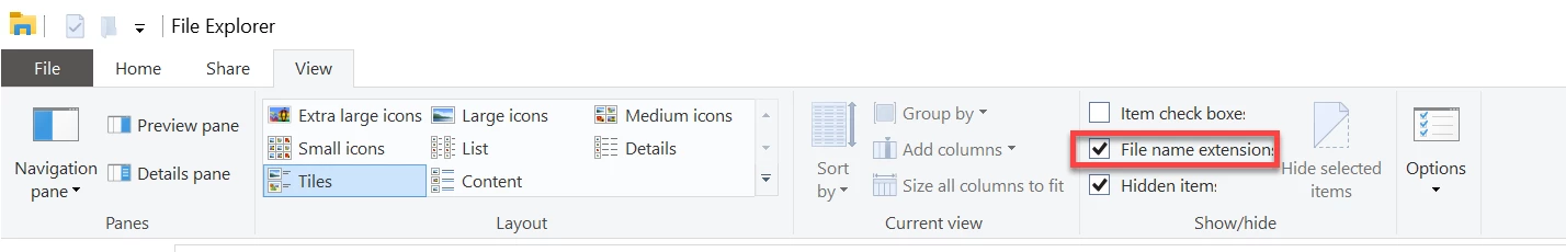

In your explorer check File Extension to see the file extension (.prel)

When I'm in PE, I'm saving the project "Save As" and also "Save A Copy" on both the computer hard drive and also the external drive mentioned above.  It's only going into the  external drive that I can still open the project and work on it (I cannot do this by opening the file from the hard drive), but even by going into the external drive I get the Skip/Skip All/Offline/Offline error and once I "X" out of that window, PE opens and I can work.  I hope that is clear.
The file import failure error message pops up when I try to retrieve the files from my hard drive, and when I "X" out of that window I am unable to work in PE.
