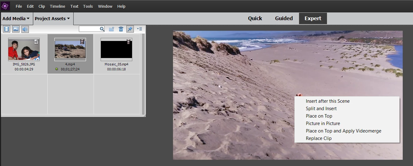

You can use PIP (Picture in picture) feature in Premiere elements to to this..
First add a video on Timeline. Now drop another video from Project Assets (In expert room) on the Monitor.
when you drop you will get option to create PIP
Another way is to use Video Collage feature.
There are templates where you can add upto 7 videos in a frame (Create > Video Collage)
