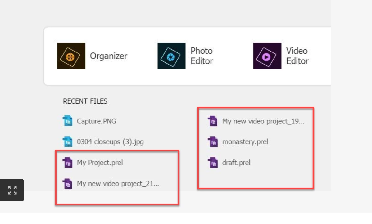

provlimaAuthor
Apr 1, 2021 3:25 PM UTC
Ann,   thanks for you reply
When i click on the icon to start  I am brought to the page pictured below
When I try to open premiere elements from that page, it does not bring me to the workspace where
I can access  security  & preferences
Ann Bens
Apr 1, 2021 3:55 PM UTC
You need to open a project first.
