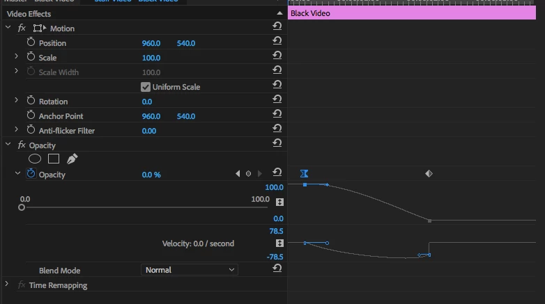

I know this was originally asked in 2012 but if anyone is still looking for a way to do this, this is what I do.
Place a black video at the beginning of your sequence and change the opacity like this. Let me know if you have any questions.
