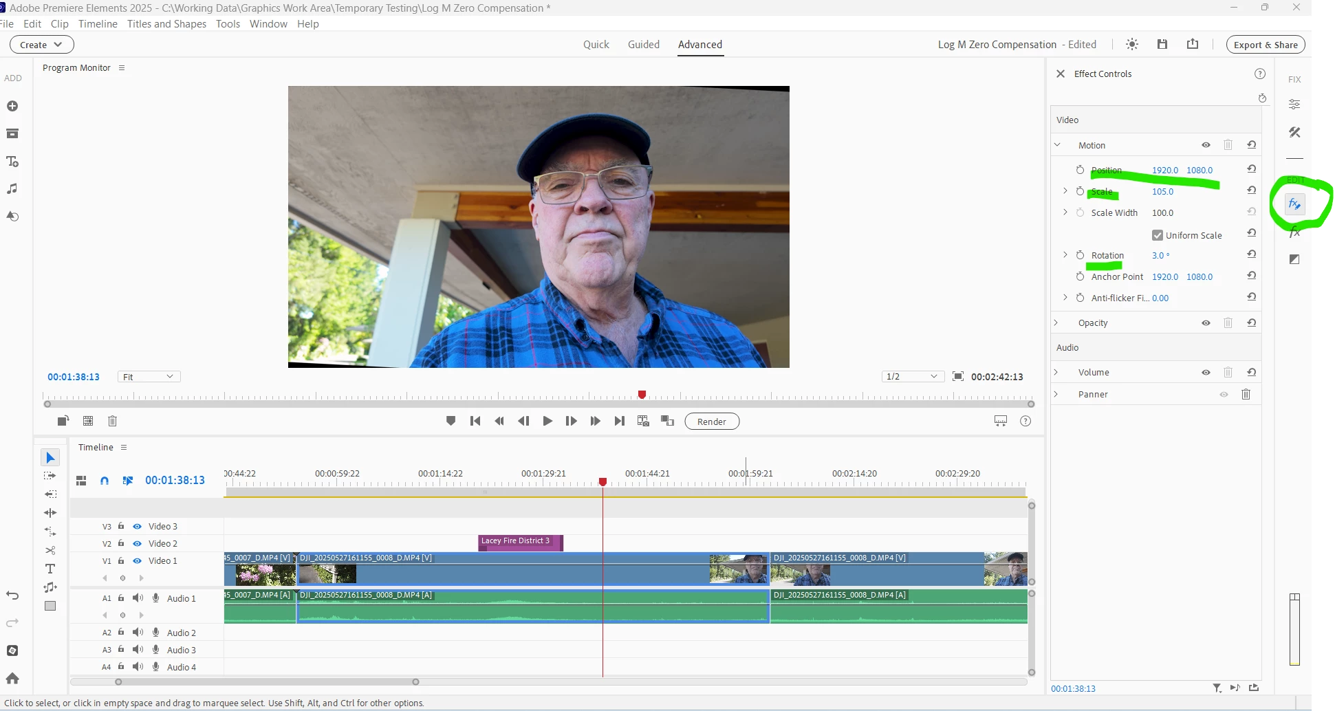

I'm upgrading from Premier Elements 2021, to 2025, and the drastically changed/new/different interface is tripping me up. Three main Q's:
1. Is there any way to ask Elements 2025 to shift back to a "legacy appearance", comparable to the 2021 version, or other prior versions?
2. What command do I use to rotate a video by a controlled and limited amount, rather than in 90 degree increments? For example, if someone was holding the video camera at a slightly off-kilter angle, such as 4 degrees clockwise, how can I return the video to normal vertical?
3. How can I zoom in, using a controllable slider, rather than the 1.5x, 2x, and other fixed increments that show up in the list of zooming options?
Any help on ANY of those would be truly useful, and appreciated.
7 replies
Jun 6, 2025 1:59 PM UTC
I don't know of any way to return to a legacy view.
For your second and third questions, go to the Effect Controls panel.  The little blue numbers work like sliders.  Hover over (grab) with your mouse and move it horizontally.
You can also do it graphically.  Double click in the preview panel and an outline with small dots appears.  You can grab the small dots with your mouse.  If the Effects Control panel is open, you can see the numbers change.

Jun 6, 2025 1:52 PM UTC
1. No
2. Effect controls > rotation
3. Effect controls > scale
Hold down ctrl for small increase/decrease value, shift for large ones.

Excellent answer from Ann, many thanks.
Re: "the outline with small dots" when I want to resize. I tried to figure it out, and use it, for several minutes, only to give up in frustration. It's like the program is asking my to use a box kite, as an adapter to help me hold a screwdriver. Sorry, but . . . I could NOT get THAT thing to work. So, I would suggest, as an early update, that they add back in one or more "grab points" with distinct sizes or colors, and allow THOSE to be used in the old way . . . i.e., simply click-and-drag, and it works.
