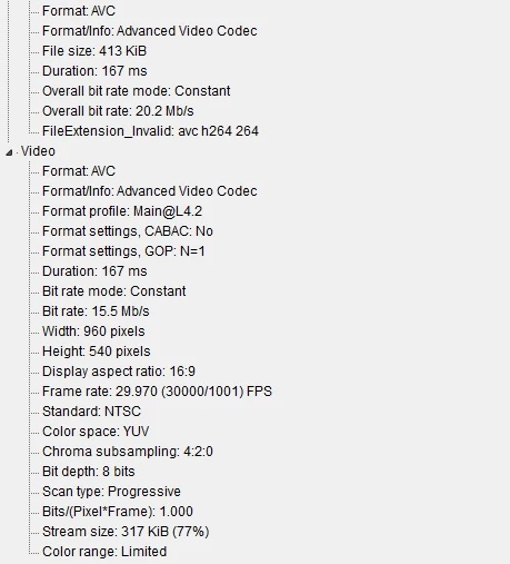

Please use the free MediaInfo and post a screenshot the properties of your media in tree view:
https://mediaarea.net/en/MediaInfo

Apr 6, 2020 5:55 PM UTC
I downloaded MediaInfo, but I don't know how to get it to provide the tree view of my project.
Apr 6, 2020 6:21 PM UTC
Is there a way to show my entire project in MediaInfo.  What I was able to pull up would be too long to post.  What I have above may be just one of my video clips.   All the video was shot AVCHD then transferred to BluRay.  I took the BluRay footage and processed it thru Handbrake to create MPEG 4 video segments which I put in the Elements 15 project.
