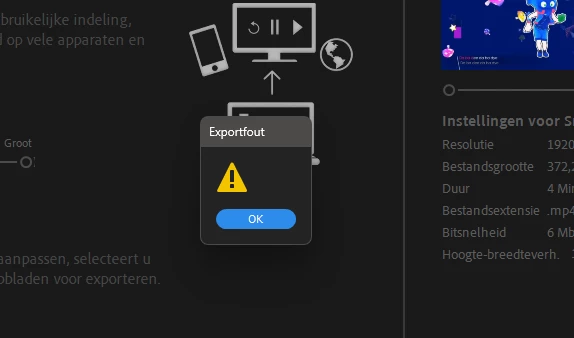

And almost everytime I want to export and share a video, the video starts rendering everything okey.
But then at 100% it gives an exporterror and just an OK button (see attached file)
However as long as I DON'T klick okey I can go to the file. Copy it and paste it on another locatien. The file there works fine. When I do click the OK Button, the file that should be saved disappears.
Yes I have acces to the location. There are files that somehow ARE saving fine. Strangest thing actually is that the file I made first did save, but then I had to cut a piece out of that video to repeat it a few times. And that file (with the same files used) just didn't save and gave that export error.
It's really frustrating, although I have a workarround.

This does not come up often and can be hard to track down.
Sometimes things like this happen when there is a shortage of disk space.   Video editors like Premiere Elements use a lot of space for temporary files.  If there isn't enough space, errors can occur.
Another cause might be a 'corrupt' or damaged source file.  It can be either a video clip or an audio clip.   Trouble shooting can be tedious.  You might try outputing sections of the project with start and stop limits set with the work area bars.

I have 1 TB of free space.
And the source file is the same as the one that didn't give the error strangely enough So source file and space can't be the problem (also I have had this with like 4-5 completely diffrent video's already, so though rare, with me it's more common then rare.
I don't understand exactly what you mean with the last sentence (english is not my native language) outputting sections?? start and stop limits??

"what you mean with the last sentence (english is not my native language) outputting sections??"
The idea is that you may have a damaged source file.   If you output the video in four separate sections and one section produces an error it would suggest that section has a damaged file.   To do this you use the "work area bars".  At the top of the timeline those "bars" or markers can be set with a begining and an end.  Then, in the output dialog, there is a small check box for "Work Area Only".
