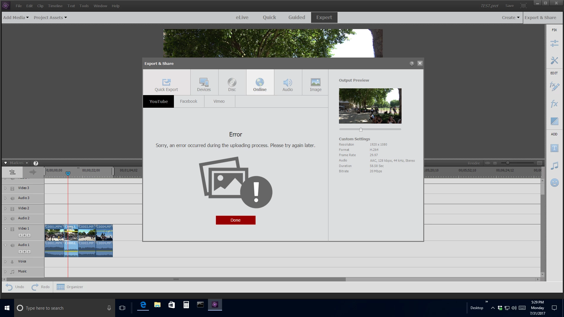

    Steve, I tried to post a little project (4 clips) a few times but every time had an error message:
    Can I just email you the clips?
