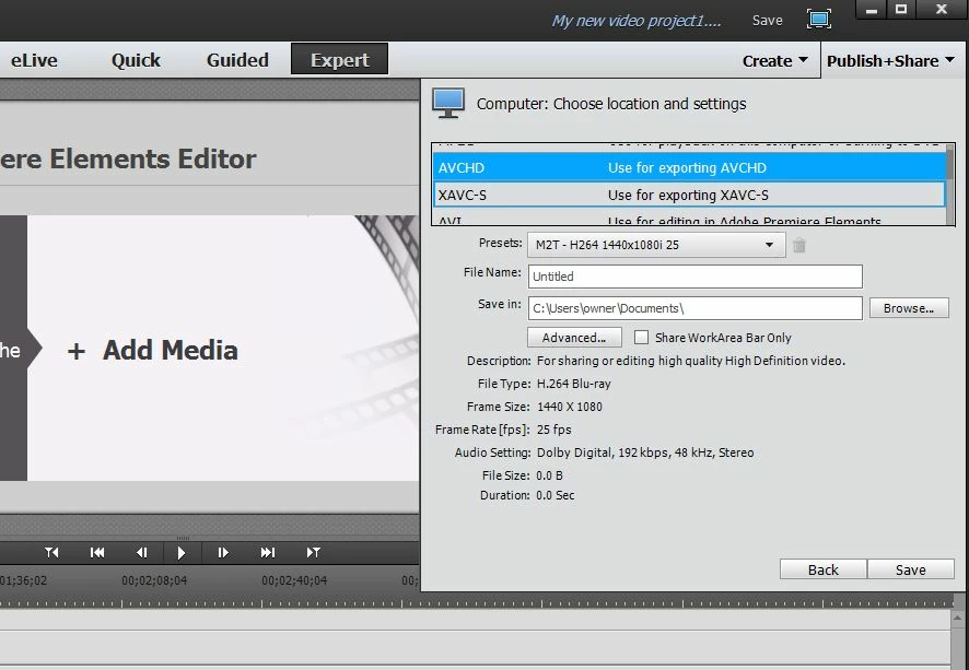

I see and understand the Publish + Share option but I don't see anywhere from it to save/export as WMV, MOV, AVI, MPG, or FLV file formats. I had a much older version of this program and it was no problem to do it. Also, the Export under File is always grayed out and I don't now how to change that in case those options to save it in the above files are there.
Glenn
Correct answer A_T__Romano
Glenn
Please remind me what computer operating system you are using for your Premiere Elements 13?
I do not think that is involved. I suspect it is the thin scroll bar but let us check that out.
Let us say that you want want to export an .avi file, you use that thin scroll bar to scroll through
MPEG
AVCHD
XAVC-S
AVI
Windows Media
QuickTime
Audio
until you scroll to AVI and then make your choice of preset for AVI. If you decide the AVI default preset is not what
you want, then you press on the Advanced Button for that AVI preset to get at the preset customization area.
As you can see, there is more scrolling to be done to get to Windows Media (wmv) which is further toward
the bottom of the list.
Please consider and let us know the outcome. If those choices are really missing, then we are in major trouble
which may require a program uninstall, ccleaner run through, and reinstall with antivirus and firewall(s) disabled.
We will be watching for your results.
Thanks.
ATR

December 31, 2014
Glenn
There is no longer an Adobe Flash Video export in Premiere Elements 13, but as for the rest, please see
Publish+Share
Computer
and its choices for
MPEG
AVCHD
XAVC-S
AVI
Windows Media
QuickTime
Audio
then set Presets for the choice....you can use the default settings for the preset or customize it under its Advanced Button/Video Tab and Audio Tab
if your preset choice has that opportunity.
There is an opportunity for .mp4 exports also under Publish+Share/Mobile Phones and Players.
The tricky part about Publish+Share/Computer/ is that not all the choices are seen unless you use the thin scroll bar to the right of the choices
to scroll down to the rest of the list.
Once you get beyond version 7, the File Menu/Export is just for saving titles created in the Titler.
ATR
glennmagiAuthor
December 31, 2014
I have PE13, I click Publis+Share/Computer, I look and scroll down all the presets, there is nowhere on any of those that say AVI or WMV. Please explain where those are?
Glenn
A_T__RomanoCorrect answer
January 1, 2015
Glenn
MPEG
AVCHD
XAVC-S
AVI
Windows Media
QuickTime
Audio
Thanks.
ATR
