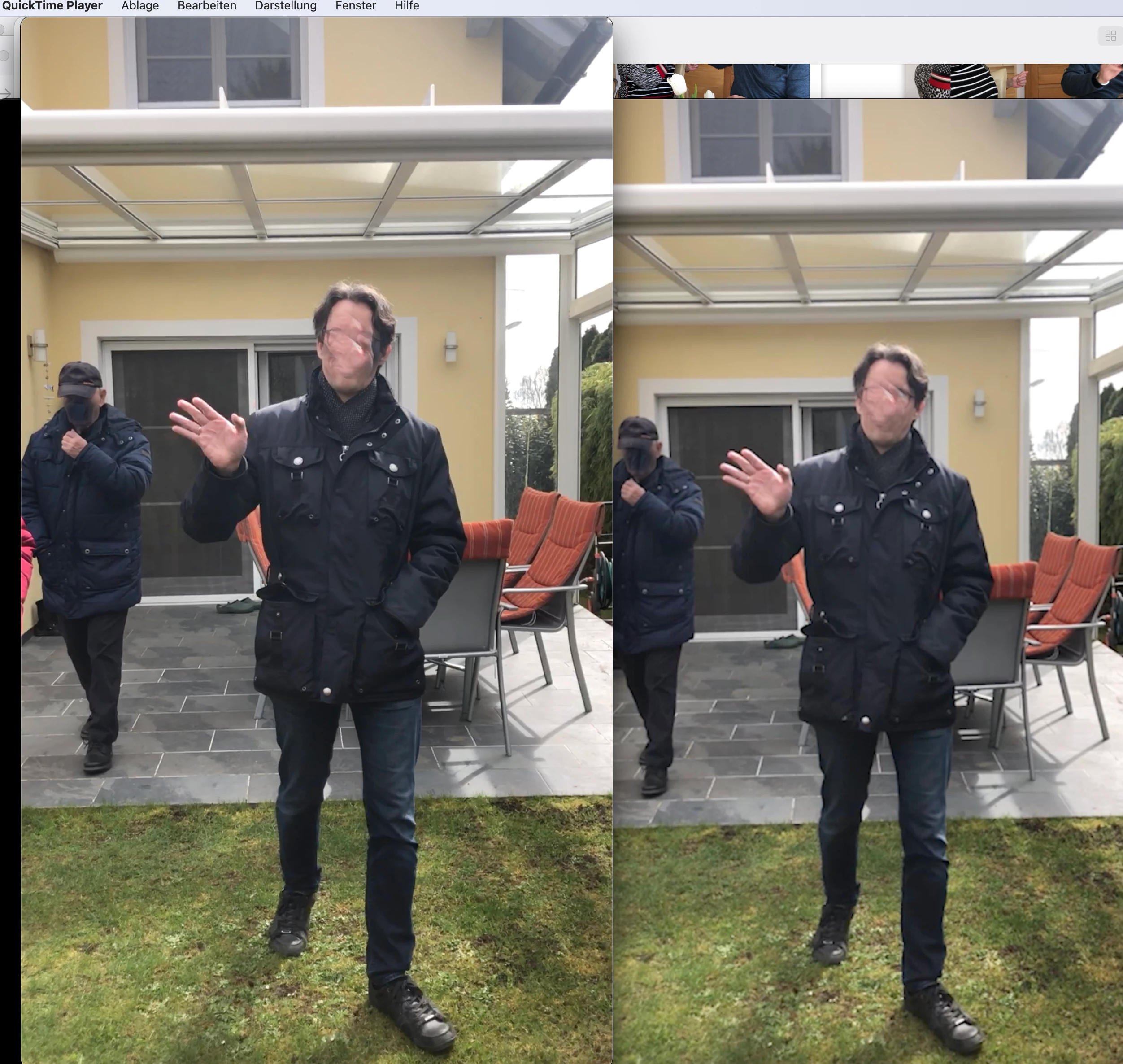

Project settings? I import the iphone .mov-file with "Add media" and pull the file into the Video/Audio1-line.  The I cut it.
Then export settings: "Computer" - "HD1080 1920x1080" "MP4 - H.264" - "Quality middle" - Save.
When I open both - the original file as well as the file I exported from Premiere Elements - the original .mov file is a) bigger and b) sharper. See attached files.
Export-settings seem to fit to iphone-settings. The only thing I can't see at the export-settings is the fps-rate.
Thanks for helping as I am a beginner.

Your workflow appears correct.
When I look at your attached JPEG, I see a difference in size, but the entire frame is included.  Using a magnifier, the detail in the shoe laces, buttons, hair, etc. appear matched.  What are you using for a viewing method and display?  I'm confused why you say the output is bad when your workflow seems correct.
The frame rate is displayed on the default output screen.  Look in the fine print on the right.
As an alternate output try, Export and Share > Devices > Custom > Advanced Settings.  Look for and click the Match Source button.  Then press OK to start the output.  You should get a matched frame rate.   In the same Advanced Settings screen there are choices at the top under Format for outputs.  Since you are in the Apple world, you might try Quicktime.
